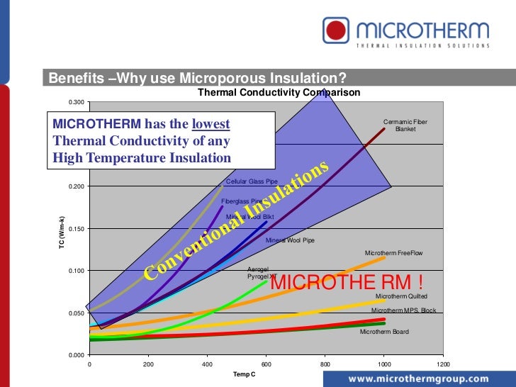

I wasn't planning on using 304. I have a source for 310 Stainless Steel thats not too bad in price. Its good up to 2000 F. Of course the minimum order means I'll need to order quite a bit of it. If you or anyone you know wants some crazy high temp rated stainless let me know. If this can't take the heat then there is another metal I can order good up to 2,200 F. and its the same metal used on the Saturn V Rocket Nozzles that took men to the Moon. If that can't hold up to the heat then I'm doing something wrong. I also have a source for a ceramic coating that sticks to metal (ITC 213, 296A, and 100HT) thats good up to well over 3000 F. and am experimenting with that. If it works out I'll forego the cerakote and use this stuff instead. Only problem with ITC is that its a three part application coating requiring all THREE coatings, and each pint of this stuff is $100 ! ! ! ! ! Its used to coat the carbon rods and interior crucible of 3 phase electric arc furnaces and is designed for direct contact with white hot molten steel!
I'll look into headershield. I'll still use the microtherm because I have a lot of it unused from a previous experiment (they had a minimum order) and a 1/4" layer of microtherm is comparable to about 1" inch of foam and it retains its insulating property's even as temperatures rise tremendously.
https://image.slidesharecdn.com/microth ... 1306230125
However its incredibly delicate so I'll still need to wrap it in another more durable insulation. Headershield looks like it would work well!
