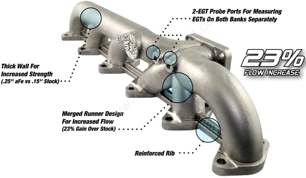

You could look at the designs they have for diesels like the AFE I put on my Cummins.
https://www.xtremediesel.com/afe-46-400 ... t-manifold
JackFish":cprvqjmm said:
I've been hoping someone might come up with something for our little engines.
I've never even thought of a log/runner hybrid thing like that, that may be a good idea. I want somewhat long tube headers, but if space does not permit, ill definitely use this design. Plus this design would be very cost efficient, look like a few 90* mandrel bends and a section of straight exhaust pipe is all you would need. Thanks for sharing
