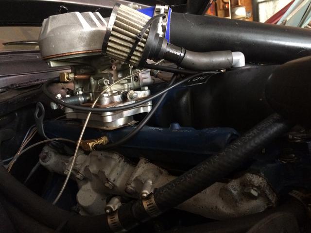

2300 - 7448 modified for Blow-Thu (Vortech SC) on simple 2X1 adapter :
Thanks for the good example. I've ended up buying a 350cfm holley clone from ebay at a good price. This looks like the best way to go forward for now. I'll post up a thread once I start really making progress on it.

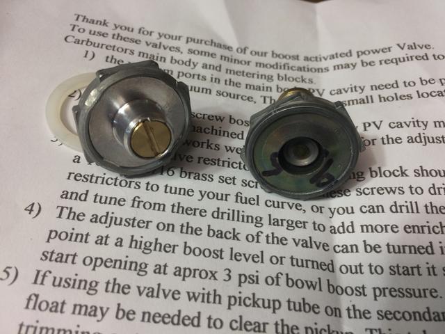

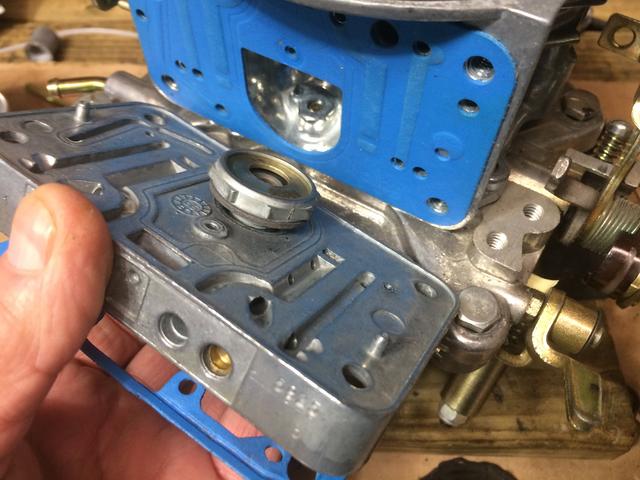

... For Holley forced induction, there is a Power Valve available from a few vendors that operates 'reverse' from NA . the PV is boost referenced or BAPV ( boost activated power valve). The PV opens under (settable) boost pressure from fuel bowl. Only related carb mod is epoxying the small base plate NA - PV port .

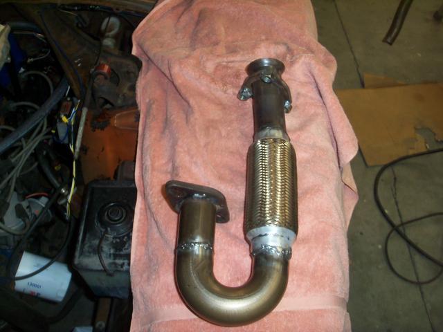

This weekend I am going to try and get the U pipe made from the stock manifold to the turbo. I've got some electrical gremlins to chase down as well to prepare for a new distributor.
A 'flex connector is recommended for J-Pipe to keep thermal Exp/Contraction from cracking/distorting.

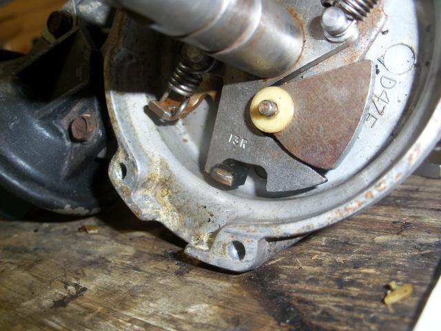

The DS-II distributor can be a good (safe) start to a forced induction project vs' more sophisticated ignition systems ($$) . The DS-II advance arm can simply be 'locked' to a maximum centrifugal advance or use an early-70's version where the factory max advance is @ 26 degrees. (The dizzy base plate reveals the advance under the swing plate and crank is 2 times dist. )
With vacuum advance still hooked up, at cruise and anytime less than boost -the vac' will still be effective adding to total advance but negated as intake vac switches to pressure.
13R = 26 degrees max:

Thanks @powerband for the pictures and holley info. I'll try and find one of those power valves, that looks like what needs to be done. I've got my flex pipe for the outlet of the turbo, didn't think to have one on the u pipe. I plan to make some additional brackets to help stabilize the turbo if I can find a way to make that work.

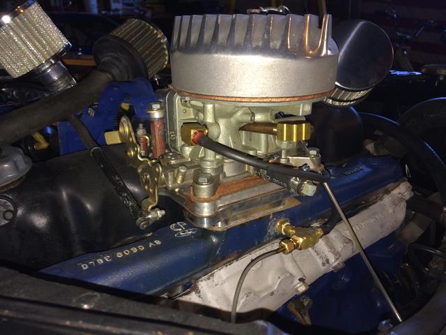

Carb came in, looks ok so far. The transfer slots show some machining issues but nothing that can't be cleaned up with a small file. Not bad for $165
... looks good, typical center hung float - manual choke 2300.
... typical blow-through mods may include milling (cutting ) choke horn, sealing choke riser linkage hole, smoothing bowl. Adding ports to PV or carb hat area as needed, sealing or pressurizing throttle shaft, welding throttle linkage plate to shaft, alterations to metering block and Power Valve circuits, , solid float, jet extensions, fuel bowl anti-slosh vent. With 'blow-through" setups, the carb jetting often is surprisingly conservative and I caution against enlarging meter block circuits before some true AFR observations. Last, fuel bowl vent extensions into charge tube is often necessary road tuning addition.
