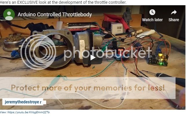

On the electronic throttle, this from JP on FEP and Stangnet
https://youtu.be/KVogEmmQZTs
EFi is much safer than servo control of a carb throttle blade.
BMW , Ford, Toyota and GM have worked through the safety protocols, and when NASA was asked to inspect the code for the Lexus 125 mph throttle jamb-on fatilies, it wasn't the coding that was an issue, the Electronic throttle has safegaurds these days.
In 1985, the BMW M5 had a throttle jamb on at Mibrook (MIRA, England), and the whole industry got into sorting out how to do electronic throttles better.
I'd like to tell everyone that it was you who first got me into exploring electronic throttle, Josh.
viewtopic.php?f=1&t=67077&p=515913#p515913
On the Turnigy Servo Tester
64 200 ranchero wrote:i bought this type of servo setup, i think i can adapt it somehow http://www.youtube.com/watch?v=KSmRWhTQ ... re=related
xctasy wrote:I'm all for innovation, but a word of caution.
I personally wouldn't ever use Servotronic accelerator cable actuation even for secondaries unless it is a factory set up. Too many issues over the recent Toyota/Lexus failsafe Nipondenso and American made equivalent electronic throttles have gone under the bridge. BMW's M5 first used a fully electronic set-up in 1986, and there were a spate of over centre throttle jambs at MIRA in the UK (by Wheels Magazine, at 145 mph in a 3.5 liter Bemmer), and documented failures elseware...this on a West German TUV approved set up, the great grannies of all conservative legislators.
When Ford made fly by wire standard on Explorers and Falcons in 2003, and on Toyota diesels in 2002, I realised that creating a vacum secondardary or fly by wire system was possible to take load of the accelerator pedal.
Use prudent judgement, but I wouldn't want to ever aid and abbet working with any servo system like that unless its got an armload of SAE degree engineers to help me out. You can pick up a smashed remote control plane when a servo fails, but there would need to be some subsidary failsafe measures before I'd ever use one of those on my tripower.
