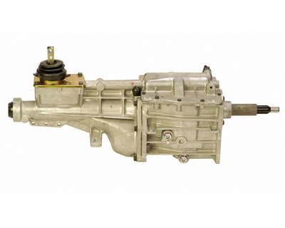

Here is what a T5 looks like, and they use ATF for oil..(as apposed to gear oil)

None of the 5 speeds look like a single rail
this is the 507 found behind 3.3 holden/ford engines it has the 5 cast into the side
