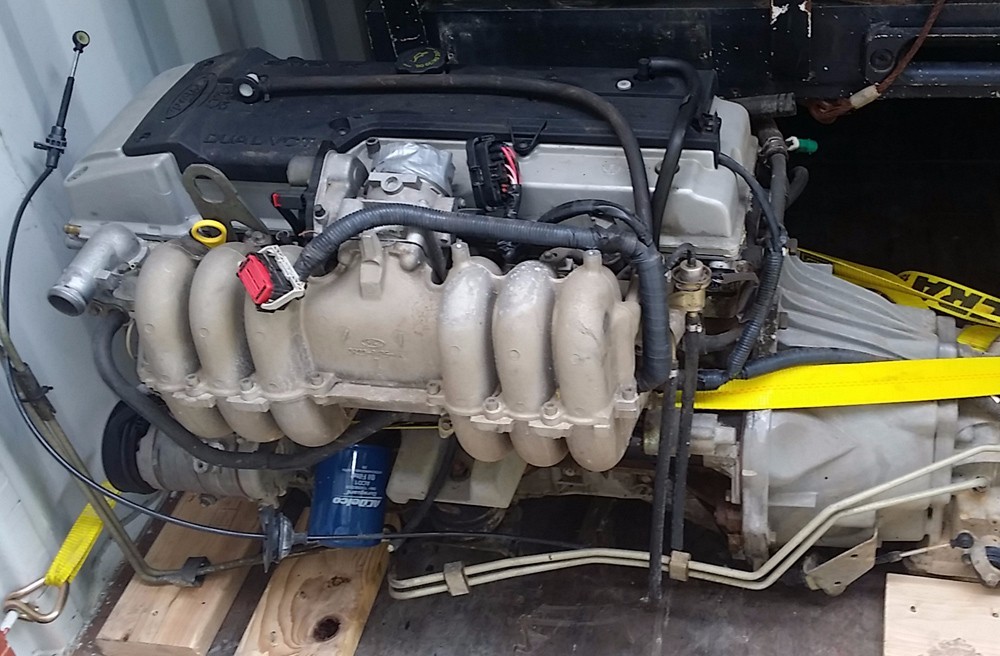

rocklord":30w64z1o said:
Here you go:
192124762262
182KW (240HP) automatic with ECU
The intake manifold may interfere with the driver's side shock tower. You can notch the shock tower or
make new engine mounts to shift the engine over to clear the shock tower.
Good Luck.
