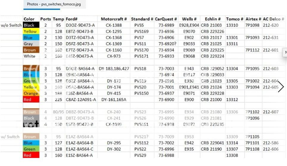

it has a vast array of chapters and parts charts, like this
