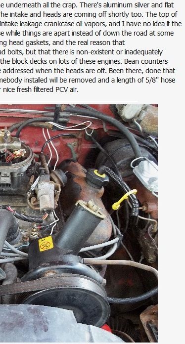

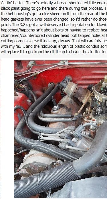

63fairlane wrote:A few thoughts...
The Ford V-sixes leave a lot to be desired for several reason. The older 3.8/4.0/4.2 types run a bit rough and are marginal performers. The latemodel 3.8 will haul a Mustang around pretty well, but it wouldn't be my first choice. My fiance has an 03 Mustang convertible with the 3.8 so I speak from experience. You will have to work out your own motor mounts and then there are the wiring issues for the fuel injection. The Duratec would be my choice, but again, you are doing a lot of fabrication and wiring. In addion, the only RWD and manual transmission platform for these engines was the early Lincoln LS. From what I understand, that particular option has been dropped so getting parts for the application will be difficult. The Supercoupe engines are another choice, but they are difficult to come by and most have been driven very hard. Plus, you are still dealing with lots of fabrication.
If you feel the need to go beyond what the I6 offers, then it may be time to look at a V8. A good 302 with aluminum heads is available from FRPP for about $3200US and it pretty much bolts in without any drama, weighs about the same as any of the V6's and has miriad options for fuel injection and carbs.
Everything became complicated when trying to make those old in line sixes servicable and meet econmy and performance targets.
The last years 1980 250 in line six engine bay looked like this, but didn't even get over the 100 hp mark.
Brave enough to service it?

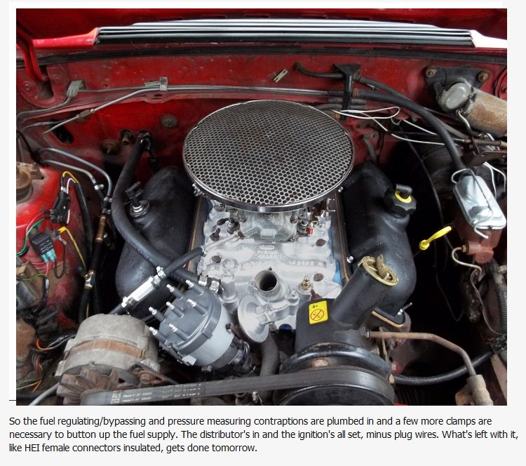

When looking at the Supercharged and 4.2 liter versions, its a whole new other ball game.
They were the next 221/260/289 Ford engine, but it terms of engine swaps, they are heaps simpler than any Electronic Throttle ODB 2 onwards engine.
But they are still complicated. After you remove the stuff, they no longer pass emissions, so there's lots of issues, but they sure do look good.
To swap a whole Super Charged Coupe engine from an MN12
to a Fox platform like a Mustang, you then have to look at this
You need to know about everything Ford did, plus you need ace fabrication skills and assistance. Thw spagetti lines of wire, and the refabricated parts on this conversion should be a clue to us that Ford really did specifically engineer everything, and its not like just dropping a 289 in a 65.

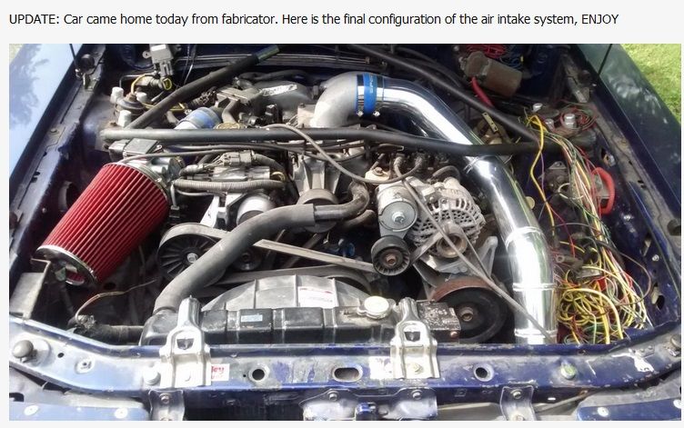

My advice is that this.
If you don't like the complication of V-6's after 1982, then you might be better off with a triple carbed in line six...like Kevinl1058's, it has flwheel corrected output of 177.05 Bhp net at 5100 rpm and 204.20 lb-ft at 3250 rpm, just with a set of three old Land Rover or Volkswagen spec Weber carbs and a nice cam, headers and a T5 to maximise the output.
Or a turbo, like "66sprint6's Boosted Inline still alive and doin well!" Matt's
