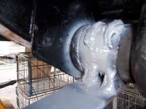

When I got my '63 wagon , it had broken springs on both sides. The tires had worn cupped sideways from the axle shifting, evidently it had been driven for a while that way!.
Here's the fun parts I've found:
Early Wagon's (Chero's?) use a rear spring eye "Standoff" rather than "Thru the frame " Bushing. This part had been snapped off from the broken springs and was hard to source... .... Early 61 Comet has different rear shackle and frame bushing apparently not available from vendors...
Back when ESPO was selling Falcon springs, I ordered set with 1" lift for the 63. They are solid and ride great.
The '61 has a JC Whitney spring pair and they don't settle to same height.
The '61 Comet rear spring was found broken at front spring Eye .
Although not recommended, for fun I tried a welded patch. This held up until I replaced 2 years later.
