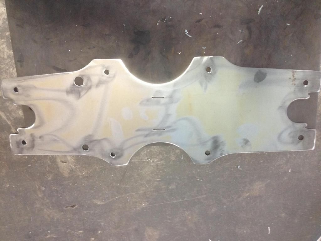

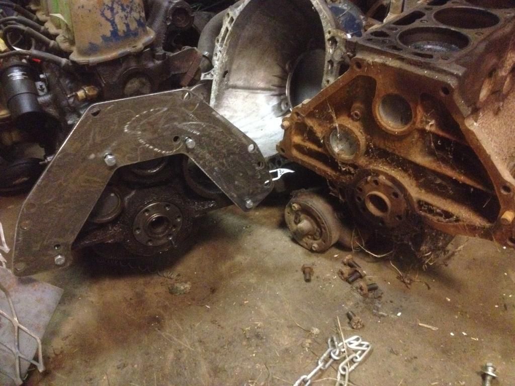

Early Falcon T5 Crossmember
A few bends later
Small Six to Small Block Ford Adapter Plate
The 170 with adapter next to a 250
