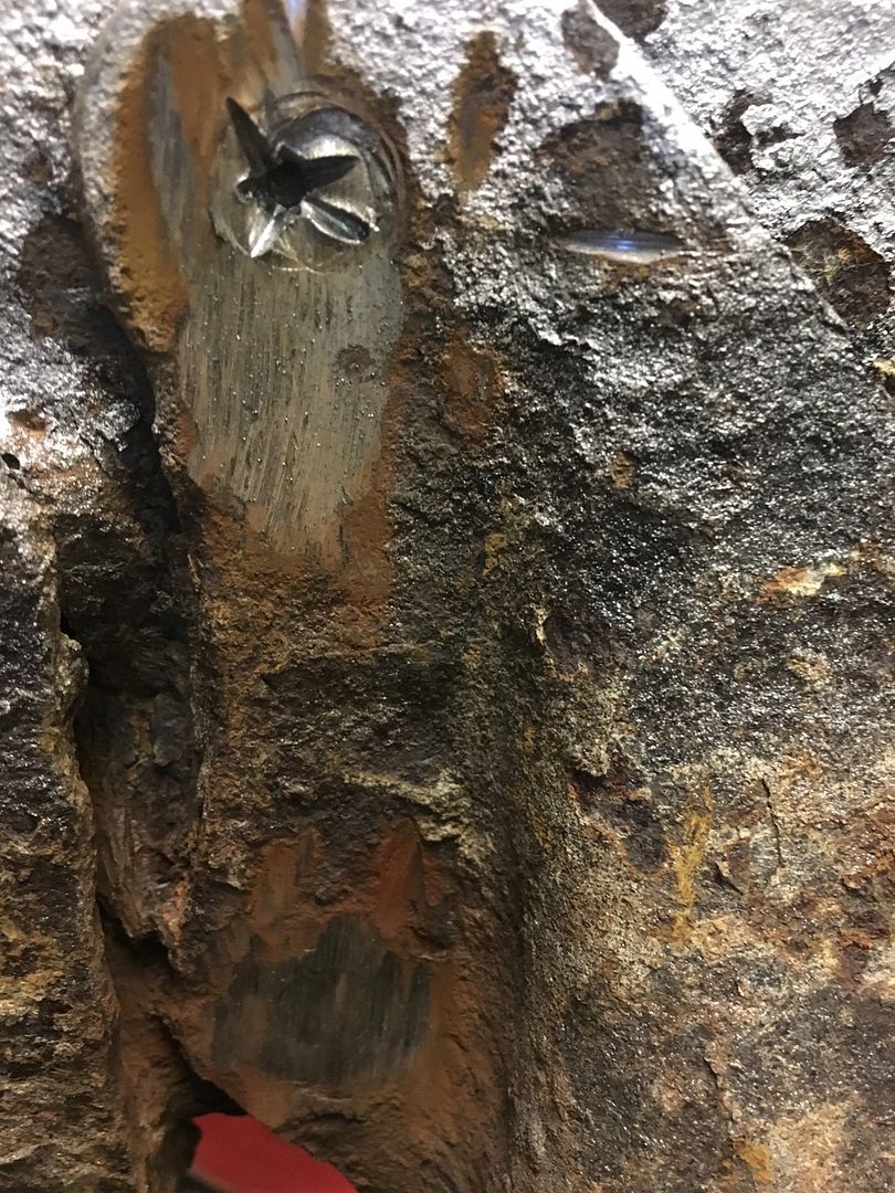

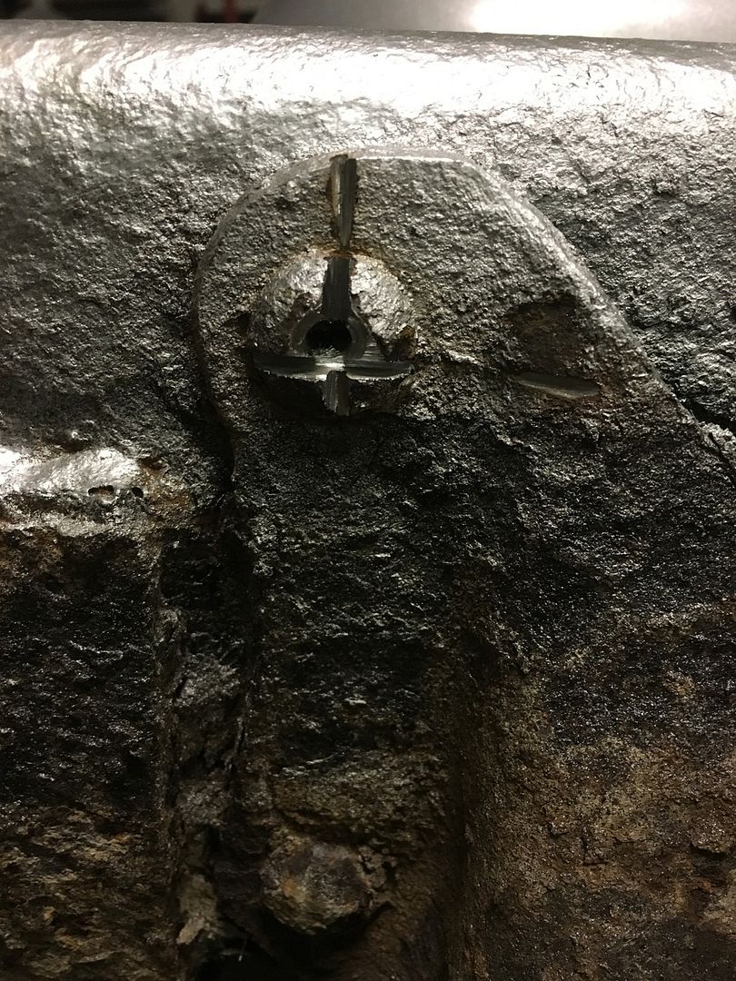

I started at the passenger side rear frame shackle bracket removing the rivets.
I tried drilling, I went through 3 different drill bit sizes, starting small and working my way up.
By the time I got to a 1/4" I ran into a lot of resistance and my drill bit dulled. That sucked, I stopped.
Then I got out my grinder with a cutoff wheel and made an X. That sucked, I stopped.
Attempt 3, grinder with grinding wheel.. what a concept.
Oh, that's nice.
For some reason I couldn't find any of my punches, I've got a half dozen of them, so I tried a small chisel and a hammer, and I tried an air hammer with a chisel bit. Neither worked, that sucked, I stopped.

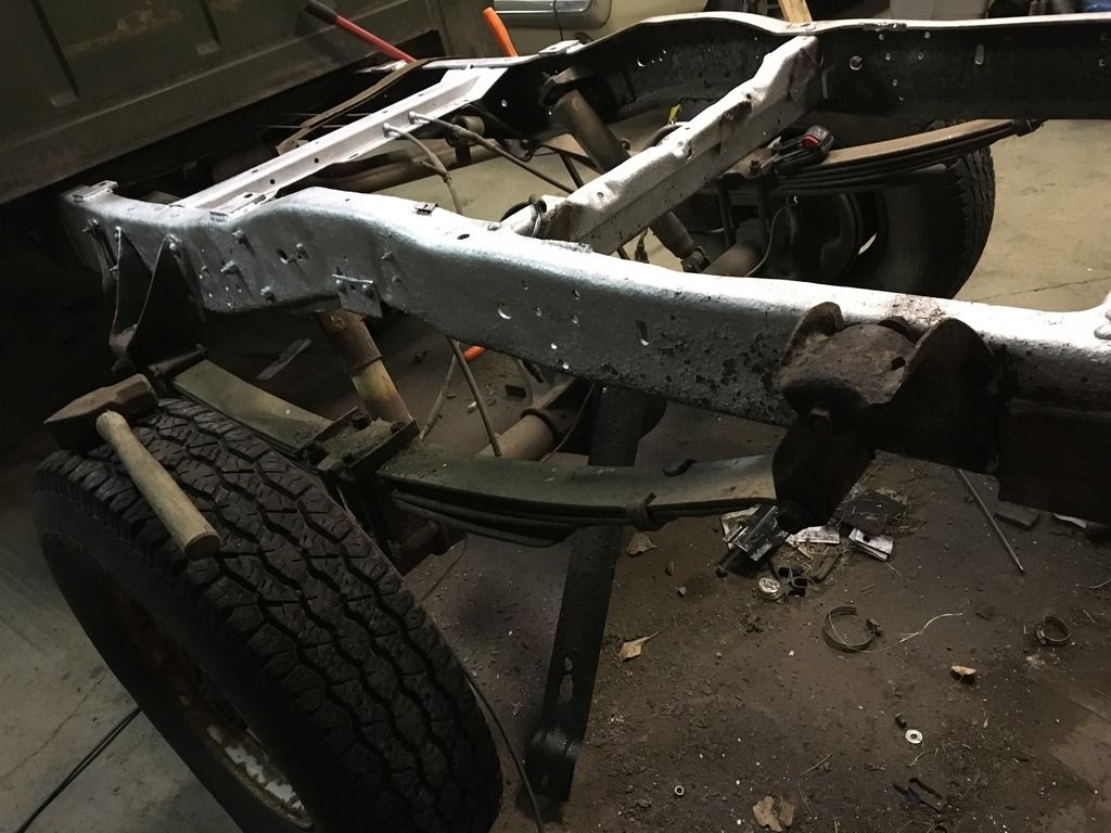

Moving on to the next phase, I removed the shackle bolt and separated the shackle from the bracket.
That gave me easier access to the lower rear rivet and the top front rivet.
By the time I got to that third rivet, I'm starting to feel like a grinding surgeon..
But I couldn't get to the bottom front rivet, the spring was in the way. So I used a couple long prybars to move it forward and around the shackle bracket.

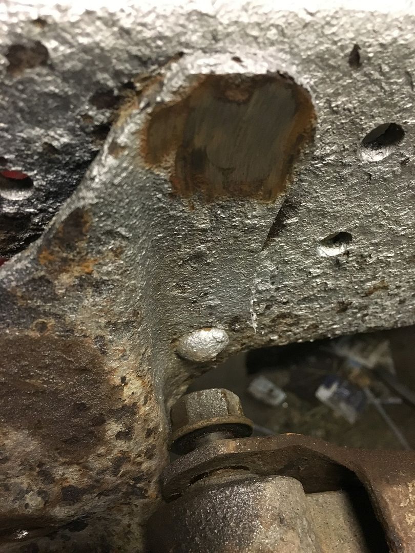

Last rivet, ground off.

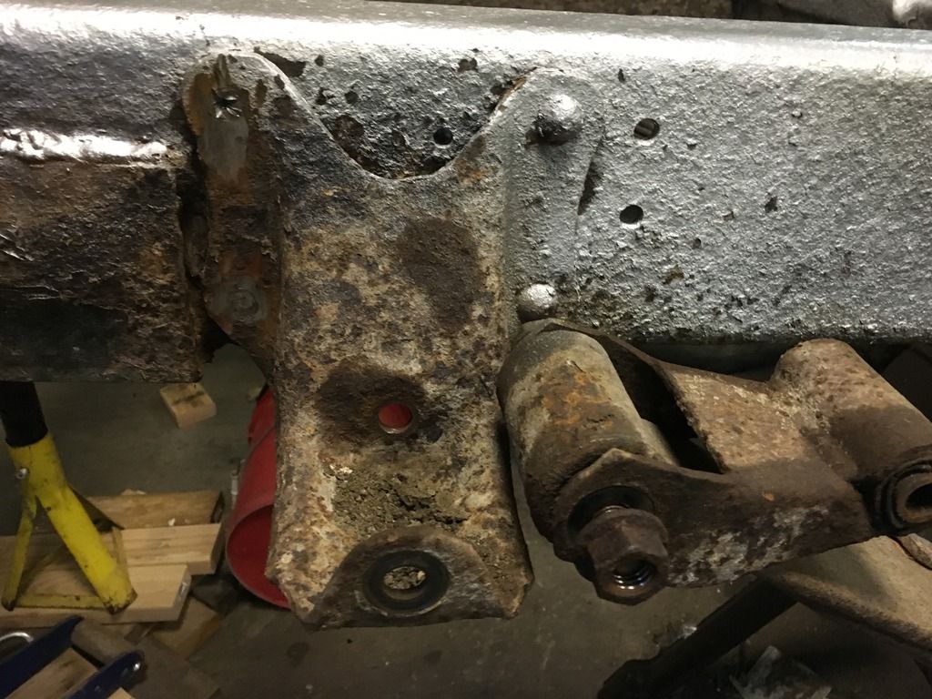

Now, to get the bracket separated from the rivets and frame, I used a large chisel and a 3lb hammer.
I don't like to hit my own hands, so I held the chisel with a pair of vice grips.
And I wear gloves..
The shackle bracket off the frame.

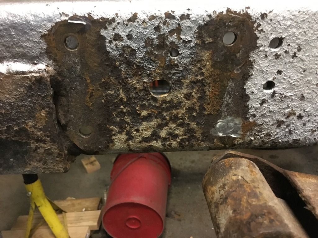

To separate the rivets from the frame, I hit them really hard with the 3lb hammer until they were flush, and then I used one of the bolts that used to hold the bed down, held it with a pair of vice grips, and hit it with a hammer.. 3 our of 4 popped right out. But that last one, bottom front, I had to grind it off flush, and then I hit it with a hammer.
I always planned on removing the huge bumpers and replacing them with either stock units or make my own. I cannot begin to describe how irritated I am about having welded on bumpers. If I could find the guy who did this, I'd slap him, hard. Or a neck punch.

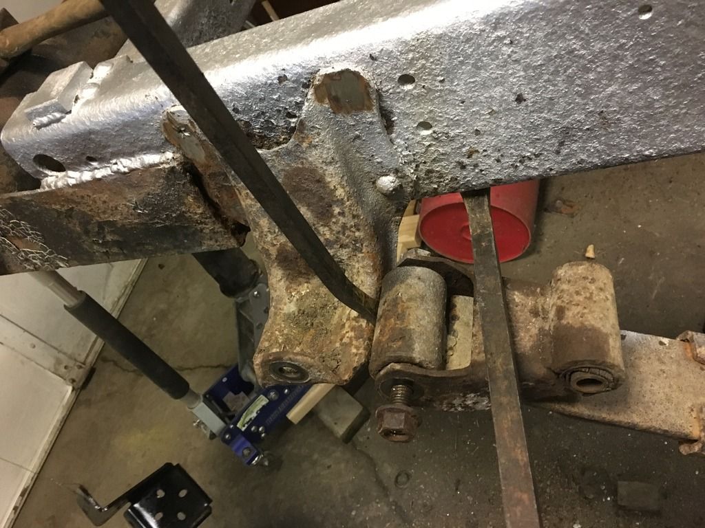

For kicks, I flipped the stock frame/shackle bracket, drilled out 2 of 4 holes to 1/2" and bolted it in place, then reconnected the stock shackle using the original shackle bolt. These are all the stock parts, just with the shackle bracket flipped, and In this picture only the passenger side bracket is done, I haven't started on the driver side yet.
Blah, blah, blah, skipping more rivet grinding, I flipped the bracket on the Driver side and reconnected the shackle.

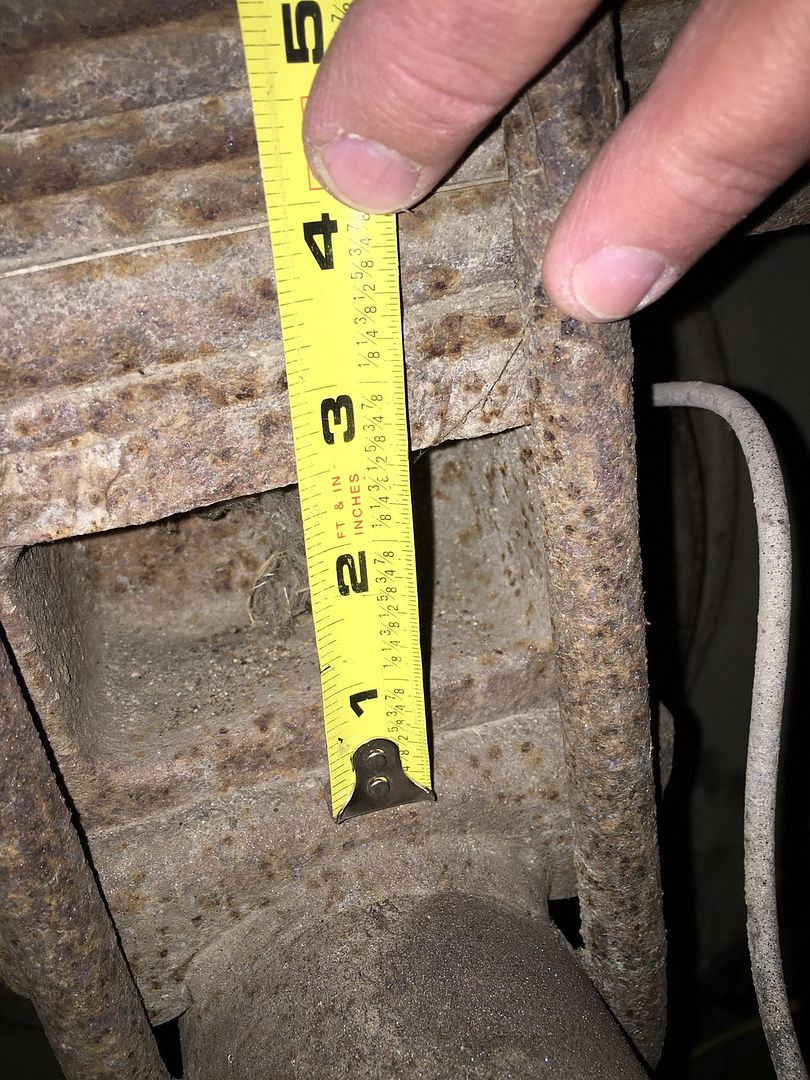

And just for the sake of completeness, I measured the stock/original/factory lift block and it is... (suspense) 3"
So my junior engineering degree says that if a person wanted to get rid of their stock lift blocks, they could use stock parts, do a shackle reversal and take out the blocks, the ride height should stay the same.

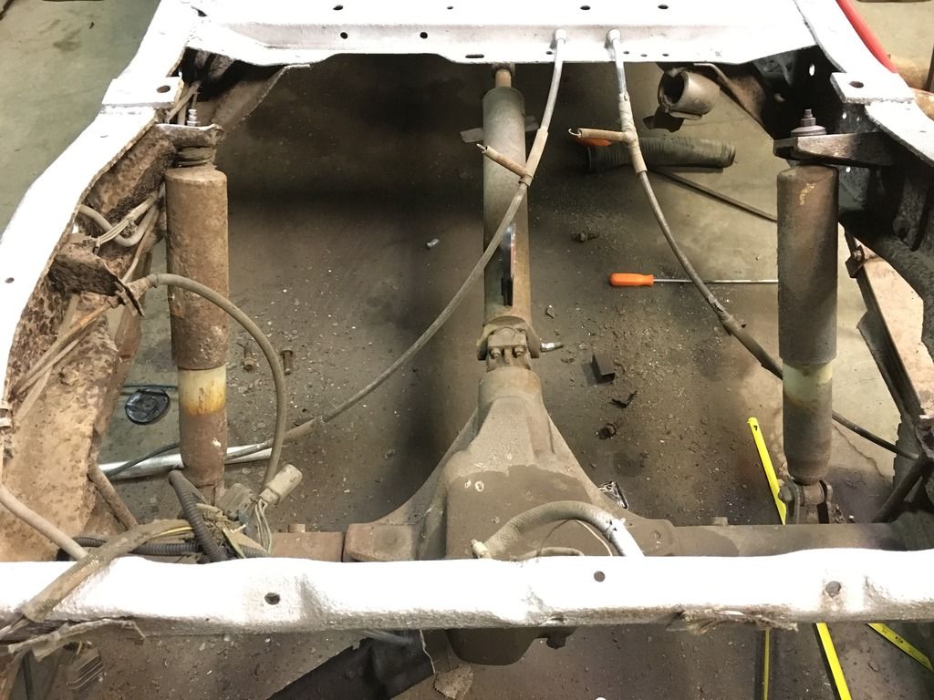

When I was lifting the frame to remove the brackets, the limiting factor was the rear shocks.
I am eyeballing that space on the passenger (right) side of the axle/driveline for the future location of my traction bar.
My idea is to make a single traction bar that has brackets welded to the axle and uses a shackle at the front.
The front of the bar will be about where the pillow block is for the driveline carrier bearing.
Or that's the plan for now anyhow.

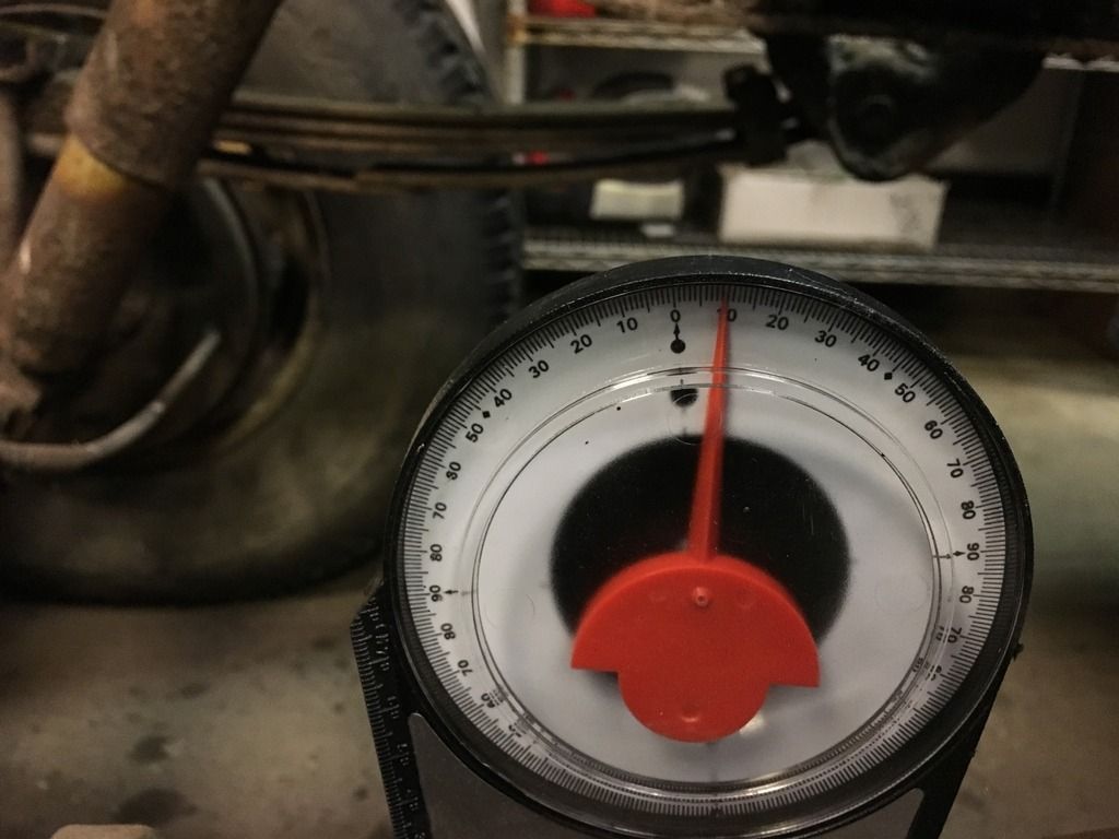

If you spotted that magnetic angle finder on the driveline, this is what it has been doing..
Before I changed anything, I threw it on the driveshaft to see what the angle was.
After stock shackle bracket flip, same.

magnetic angle on the driveline.
I'm going to go out on a limb and say this measurement is useless, because it doesn't actually tell me anything about the pinion angle, only the difference in driveline angle as the axle moves farther away from the frame.

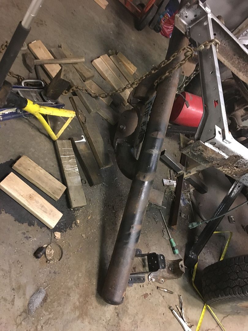

This morning I completely removed the passenger side leaf spring and hangers.
I removed the rear shackle bracket and shackle
I attempted to remove the nuts from the original u-bolts.
No dice with an electric impact or a 2ft extension on the end of a 1/2" ratchet.
I like my ratchet, so I didn't try to terribly hard with the ratchet.
So I cut them off with the grinder. Let me tell you that was not a fun experience.
I cut through the first one and there was a loud POP as the grinder cut through the last half of the bolt.
I wasn't sure if the tension was because I still had the driver side shackle side still in place or what other force it was.
So I removed the driver side shackle bracket and shackle, then blocked the whole thing up using my custom stand.
After cutting the other U-bolt in half, and pulling out the front leaf spring eyelet bolt, I took the leaf out and laid it next to the new one.

OK, this is how the new springs will sit when everything is said and done, these are bolted in at both ends and the center pin is through the pad on the axle.
Nice and Flat
Shackle angle isn't quite as much as I was hoping for, but its still decent.
From the front
And the important part.. what has this whole spring swap netted me as far as a gain or a loss.
Original figure was 11"
New number with 2009 springs and shackle flip bracket, NO LIFT BLOCK... 14.5"
I'm pretty happy with that, 3' gain over stock.
But I had time to kill and wanted to know for future use..
2009 springs, no lift blocks, stock shackle bracket in their flipped mode (shackle down)
A shackle angle that is concerning.
Top of axle to bottom of frame measurement... 12.0"
And lastly
2009 leaf springs, no lift blocks, shackle if its original configuration (up)
Shackle angle is pretty good for an "up shackle" position
Distance from the top of the axle to the bottom of the frame.. 10.25"
Summary
2009 stock leaves (66" long)
1977 stock shackle
shackle bracket (stock = S, flipped = F)
Shackle (up = u, down =d)
Distance from Axle to Frame
SU = 10.25"
SD = 12.00
FD = 14.50"

Yesterday my 2005 F250 6.0 PSD decided to kill its water pump, so I had to quickly assemble what I had so I could move it out of the shop.
I drilled out the front spring mount with a 51/64th drill bit so I could use the stock 2009 leaf spring bolts.
I had new spacers cut, 1.25" and 1.5", I tack welded them onto the leaf spring mount.
To me, it looked great.
Stock 1975 bolt that holds the shackle to the bracket.
2009 bolt that holds the shackle to the 2009 leaf spring.
The U-bolts I had made locally, and I totally screwed those up. They are too wide, they are too short, about the only thing I got right was the bolt diameter. I had them made with 3.5" between the uprights and there should only be 3.25" To get them in place I used a vice grip clamp.
And finally it is together enough to get it out of the shop under its own power.
*almost*
The last piece of the puzzle, I needed a temporary gas can, so with 5 feet of fuel rated hose and a 5 gallon gas can, I rigged one up.
By removing the bed, this is all the crap that DIDN"T fall on my head or in my eyes.
All swept up.
With the 2009 springs installed in the rear, I backed it out. Its got a decent rake now from rear to front.
And I almost drove it to work today, I'd have dropped the box back on and held it in place with a few bolts, however when I hit the brakes.
I feared that I had damaged the hose when I was lifting up the frame for the leaf spring test fitting and fabricating.
I'd like to replace the hose with a longer one, along with the emergency brake cables.
And with that, I'm calling it done-ski on the leaf spring install.
