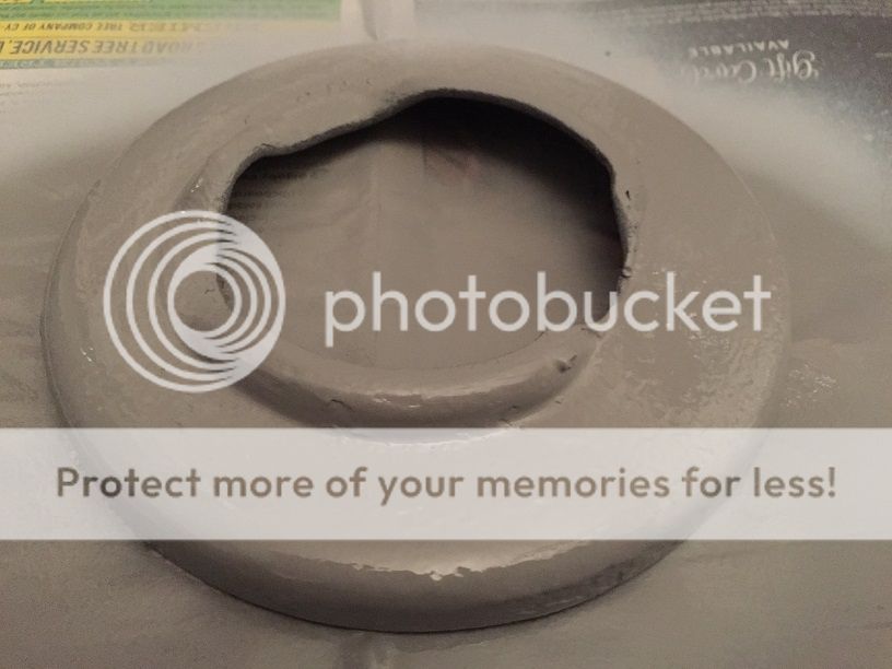

When I took the old front coil springs out, a flat, circular metal piece was on top of it:
If there was ever anything else, like a rubber piece between the spring and the metal piece, it was long gone.

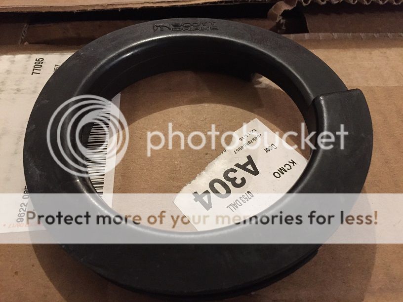

The new springs from Dearborn Classics came with rubber spring insulators:
Are there to REPLACE the metal insulators, or to use IN ADDITION TO the metal insulators?
