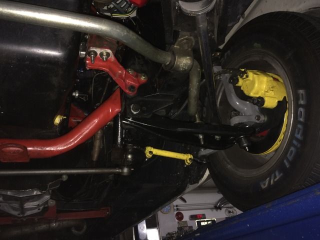

I am looking for pics '65 V8 type Manual Steering setup on an early Falcon.
I have a 61 with a 250 and need to see if steering gear will clearance the 250's SBF V8 Bellhouse and Starter position.
Thanks

The Ford Falcon Club has good pictures of this swap though you have to be a member to see their magazine articles and pictures. You might be able to see some of what you want in this group of posts detailing this swap at the below link.
http://www.falconearlybirds.com/smf1/in ... pic=1261.0
Good luck :nod:

Thanks for the excellent info , just what I needed to swap in the heavier duty V8 setup.
... my '61 has '71 Maverick six spindles and currently uses the six steering gear with center link 'flipped' to clear SBF bell and 'Mustang Steve' outer tie rod bushings to fit the later spindles.
