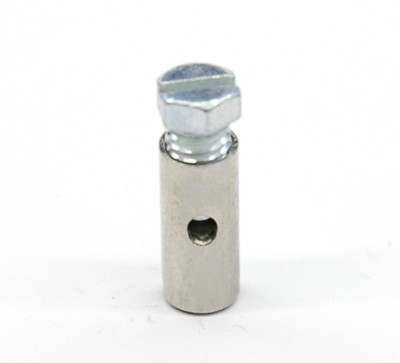

i solved the problem on my mustang with a bicycle brake cable anchor and the lokar cable:
you might get this from your local bicycle or motorcycle dealer.
