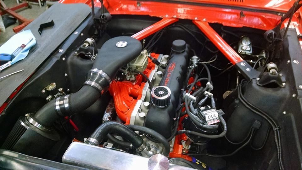

Well I put the Holley 390 on and it runs pretty good I think it just needs a little more tuning, only issue I am having is clearing the hood with the air cleaner, 65 Coupe could you post some photos of your set up?

Post #8 by 65-coupe » Fri Oct 14, 2016 8:39 pm
Low profile carb hat. I also have a 10inch round filter with a 1 3/4 air filter. I do not have a pic of it.
