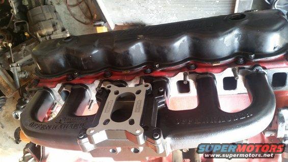

You could weld the injector bungs to your Offenhauser intake runners and use an Edelbrock 90 degree throttle body adapter with something like a 70mm throttle body.
The stock EFI lower half has the injector bungs and would need a plenum fabricated to accommodate a throttle body.

Thanks for the reply. I don't have much in the way of fabrication tools, so anything/everything I did that required welding, cutting, etc. would need to be farmed out, which would add up. Drilling and tapping injectors into an Offenhauser intake did seem like an intriguing middle option since that's about all I could do myself. The stock system is already set up for this engine, so I'd more than likely go that route (if I did) and then modify it.
However, I'm mostly curious about the pros and cons of each system. I like the idea of the self learning TBI because I can just bolt it in place of the carburetor and set it up. There's a lot to be said about that. Plus, hey, self tuning.
Then MPFI obviously has its benefits.

I was able to trade my Offy DP straight up for a Offy C, so that part is good to go.
I think at this point, I'm pretty set on the TBI idea. I never had issues with how carbs performed, I just had issues with cold weather operation, keeping them tuned, trying to get my throttle response crisp, etc. So, a "self tuning carburetor" is honestly good enough for me.
I know there are a number of good units out there that I could hunt down and retrofit, but at this point, the Holley Snipers are so decently priced ($899 for about everything I need), it's hard not to go with them. Plus.... having a warranty is nice.
However, I'm always open to other ideas.

One thing I had going for me was that the Bronco was already fuel injected, so I didn't need the full kit. I was able to reuse the stock EFI fuel system, which made my job a lot easier.
I swapped out my Offenhauser DP for an Offenhauser C, since the EFI would probably get messed up by the dual port intake setup.
The 550 kit is also a 2bbl 2300 style, so I used an adapter plate.
My review is a total "two thumbs up" A+. I really, really like it and will never reinstall a carb except as a last resort. Aside from some mistakes on my end (like the distributor in 180° out) it fired up immediately and, even after doing any self learning, drove better than any carb I've ever had on the engine. Snappy throttle, smooth idle, and easy to work with.
