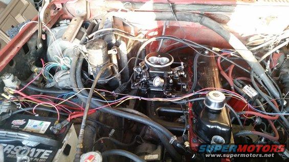

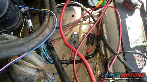

Post #17 by AbandonedBronco » Mon Jun 10, 2019 5:25 pm
Ffkohler wrote:Do you have any more pictures of the install?
I do. Lots more.
Here's some of the highlights.
I found a coolant return inlet that was threaded for the ported vacuum switch, which had the same thread pattern as the coolant temp sensor.
AN-6 Fuel lines
Fuel pressure test. :D
Wiring...
https://www.youtube.com/watch?v=TT7qH_dvZnQ
https://www.youtube.com/watch?v=Ah7alvyiYT0
1985 Ford Bronco Eddie Bauer. 300 I6. 9.1:1 CR, roller rockers, EFI manifolds and 2.5" exhaust. DUI ignition. 3.55 final drive, 5 speed ZF5. Holley Sniper EFI w/Offenhauser C Intake. 32" BFG KO2 A/Ts.
