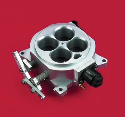

what is another throttle body and or setup that is better
Define Better.
http://store.summitracing.com/partdetai ... toview=sku
well, mid 80 v8's had a four barrel carb-looking TBI unit. It wont bolt up to the 200's head as is, but with an adapter it should.
I dont understand what you mean by "modification possibilities."

MS2 can do a stepper type idle air control and drive an ignition coil direct with something like a DS2 dizzy (no module required). Other than that basic fuel functions can be done on either one. The version 3.xx boards have several options built in that are not on the 2.2 and earlier boards. One notable is the flyback stuff that is needed with low impedance injectors. Most injectors over about 40 lb/hr tend to be low imp which includes all TBI's that I have ever seen. If you somehow made that 4bbl fit I guess you could have high imps but you would then have lots of other issues to deal with.
I used a Holley 12-927 pump on my system. jegs summit type places have them. They come with the clamps and fittings and such. I mounted mine on the flange of my fuel tank with beam clamps from my local home store. I have heard many others complain about the noise of electric pumps but I can only hear this one when I first turn the key. With the engine running I can not hear it even if I listen for it outside the car. My car has heavy duty truck mufflers on it so it is not loud by any stretch.
Addo, those TB's in that link look pretty cool. I may just be dumb tonight but I can't see anything but that one page. I want to see what they cost and if they have TPS and such also. I may be able to figure it out in the morning but if you have a link to their main page I would not have to think so hard.
