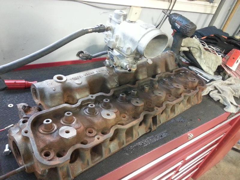

Do a search on the Tempo TBI unit. Would probably work well on a stock 170. With a 2 barrel mod you could go with gm 2v TBI. I have seen a thread on here once where someone bunged a log head for multiport, but I don't remember seeing the outcome after that. Multiport would be easier with the aluminum head, but you'll have a hard time fitting the intake manifold in the doghouse I'm afraid :devilish: I've considered doing 2 Tempo TBI's on a large log head for my 250.

https://grassrootsmotorsports.com/forum/grm/draw-through-turbos/75702/page2/
Picture from the grassroots thread:
