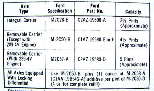

Daft question I know but I assume from the list below my diff has to be the 1st in this list; C2AZ-19590-A (integral carrier)
.. . . (what actually does integral carrier mean as opposed to the others ???)
Cheers!
Cheers!
Re: 7.25" Differential Rebuild
ahhh. got ya!
Cheers R
