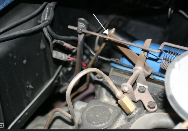

This is the kick down lever on the Mustang z-bar throttle linkage:Image

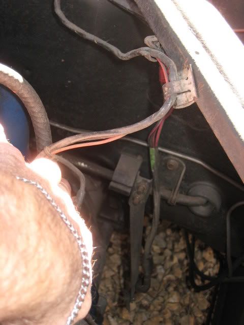

Where it is connected, right next to the master cylinder on the firewall:Image
You appear to have some kind of bell-crank thingy that is actuated somewhere else. Seems to me that you are missing the stick that hangs down from the z-bar. Of course, it might be connected on the other side of the block, but I don't think so, looking at the pics from the manual. Have somebody push on it while you watch. If nothing moves, it needs to be either tightened somewhere or connected somehow.

This is what you are or should be looking for. The arrow shows the kick down lever anchor with threaded shaft. I got this from the internet; googled "'63 Comet kick down lever." So it WAS something on the other side of the block. Of course, this is for a V.8, not a six. But it comes close to what is shown in your manual.
