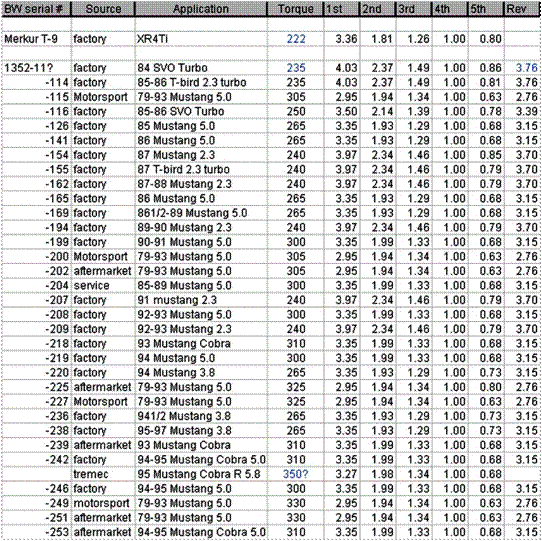

1352-114 Ford 1985-86 T-Bird/Mustang/SVO 2.3 TC L4 WC P 3.76(rev) 4.03(1st) 2.37(2nd) 1.49(3rd) 1.00(4th) 0.81(5th)
Is the input shaft smaller or is the tubo L4 the normal 10 spline with the same diameter as the L6 and small block stuff? I got a 67' 9" clutch setup on mine. Would this work?

Yes a 4 cyl T5 can work fine if you need to finish and drive. The question if it's the right T5 is more about how you want to drive.
... gearing of the discussed T5 :
... an extreme low 1st gear (4.03:1) and limited OD(1:.81) is not best match with a typical early OEM 3.50:1 rear. The 1st may not be usable and OD may not let the torquey (slow-spinning) small block six use it's most effective powerband . With a 2.80 :1 ratio it may be more drivable.
Typical V8 T5's use 3.35 or 2.95:1 ratio 1st gear and Overdrive is 1:.68.
ALSO - the usability question of WC or NWC is way over rated. Main difference is better low temp performance due to use of ATF and roller bearings - BUT - Nothing is wrong with NWC V8 T5's in small block six use. I use a NWC V8 T5 (13-52-126) for @ 10 years in my 63/ 170 with only a little stiffer shifting and may have preferred higher 2.95:1 1st gear.

So the 2.8 that i have is actually ideal for it? I wouldn't have thought that i would've at least thought 3.2 would be the better one. But the torqueiness is good.
I can't find out from the site you showed me if its a WC, but heres a site I've been using and it says that the number is a WC.
This will be used as a daily driver and the first gear is nice for all the hills we got here in western WA. And the OD aint overkill on the 2.8 rear. Would you think a V6 or V8 T5 would be better suited? I outlined the mods near the top of the thread, i wont be putting out serious power
