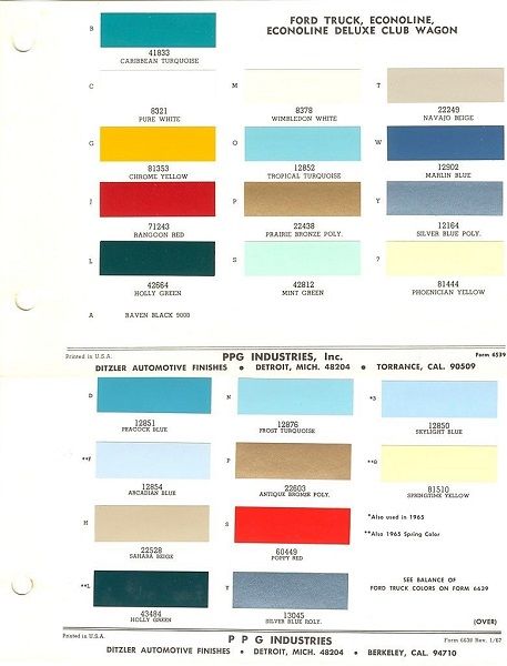

Hello All,
Repainting 1965 Econoline original Holly Green color :) Looking for any information on original color code for Holly Green on 1965 Econoline.
Thank you!!!

The Holley Green (Dark Green) is color code L. The Ford color code number is M1237 that color was used on 1961 to 1967 Ford Econolines and other Ford model trucks to as late as 1991 (under different door codes of B,C,7D, & SD). Most good automotive supply or auto body paint supply stores should be able to mix that color from the Ford number code. Good luck on your paint job. :nod:

Awesome Thanks!
