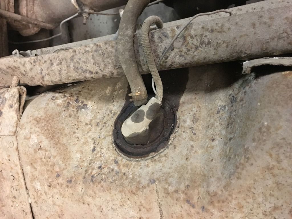

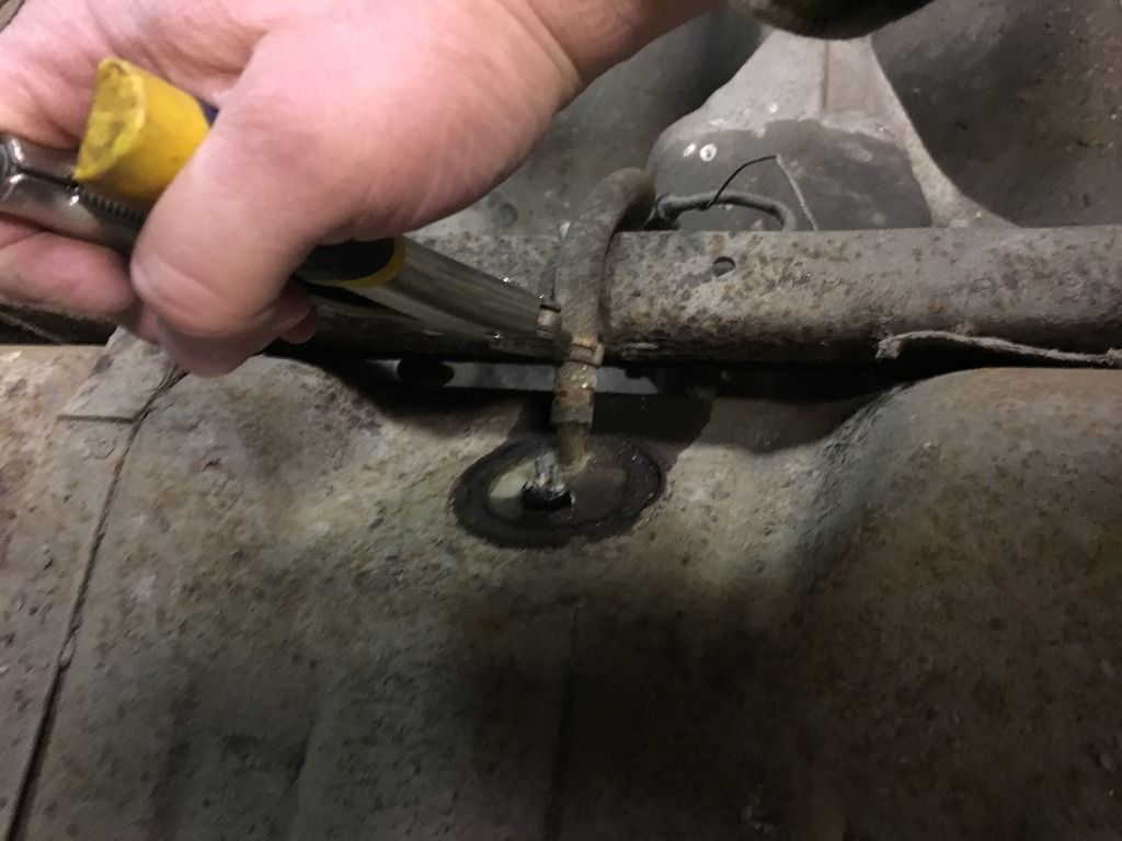

I started by pulling the sender unit pigtail.
Then I removed the fuel line from the sender unit.

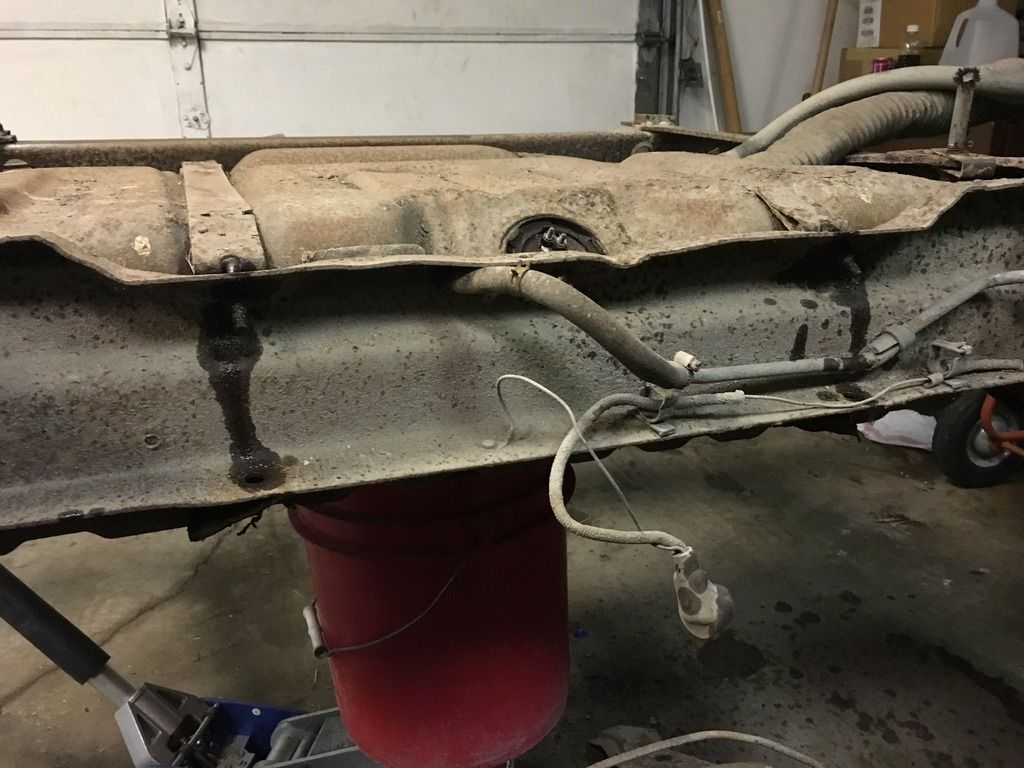

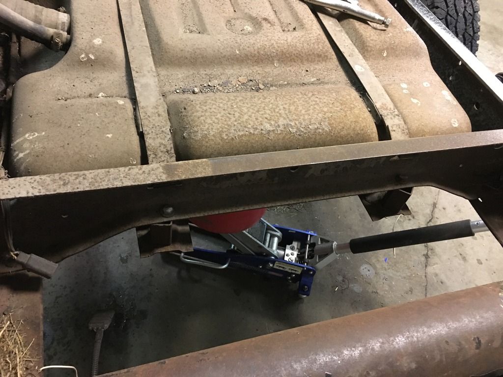

I supported the fuel tank with a jack and custom holding block.
While I removed the bolts that hold the lower tank straps, these two at the front.
And these two in the rear.
