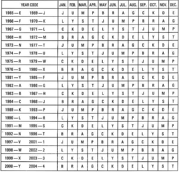

Post #2 by xctasy » Mon Sep 27, 2004 7:23 am
JG31XS is a Geelong made JG, Broadmedows assembled 31 Wagon engine, Sept 80 (x= 80, s=Sept).
See discokin6's posts, and look further at
http://fordsix.com/forum/viewtopic.php?p=19308&highlight=#19308
addo has the best code breaker, but it looks like its logged off at the moment. http://www.fomoco.com.au/
My Pano runs JG45XB,( 45 = Panel Van, X=80, B= second month, Feb)
If its a Gold Coast/Brissy assembley, its JL, but still made at Geelong.

Post #6 by xctasy » Fri Oct 01, 2004 5:48 am
selwonk wrote:my engine number is JH71CG79800C. any ideas what this is out of?the donk currently is a resident in me old xf shopping trolley!!
Care of addo and discokin6
J= Australian Ford
H = Assembley plant Code. Don't know about the type of streamlined plant alterations after 1985. The Geelong plant was rejigged after the Clevleand was axed in 1983.
71, body type, I don't know what it is. Could be a Fairlane or LTD
C = Year code (C is 84);
G = Date code (G is April)
The 4.1 engine was also being made for the F150 and Bronco, but only till 1985, so its likely to be nothing other than a Falc, Monty, Fairline or LTD. Can't remember when the Falcon based Nissan Ute came out.
Kiwi cars got codes like MEA for exports, then the JG or JL or JH no.
I've got JC 31BT 313520 for a 83DA 6015 block. It was a wagon too!
I've got JG45XB for a 76 DA 6015 block. It was a Panel van
I've got JG 35GB 55777 for a 84 DA 6015 block. It was from an EFI Fairmont Ghia, I think.
Looks like
22 is a base Falcon
23 is a Falcon 500
31 is Wagon
32 is base sedan (although some have said its a Fairmont Ghia)
33 is a Fairmont, Futura or GT sedan
34 ??is Fairmont Wagon
35 is Fairmont Ghia
45 is Panel Van
61? Fairlane
71? LTD
The codes were shown in Muscle Numbersin Australian Muscle car, and the rest is from cars I wrecked lately!.

Post #10 by xctasy » Fri Oct 01, 2004 7:57 am
GASSED260 wrote:Do these nombers mean anything to ya
CG81UB15583C
September 1978, Code 81 is, what, a Landau or F150 or Bronco or Cortina or Transit.
CG looks a little odd. Its Geelong assembeled, but C is a code fro another country.
Most likely JG81UB etc etc.

Post #13 by xctasy » Fri Oct 01, 2004 8:17 pm
Imported engine assemblies
I was in bed last night and then it hit me! If its a four, Australians never made it in there own country. I don't even think Ford made Mazda engines for Telstar, Ecconovans, Meteors, Lasers, Capri FWD, Festivas etc in Australia, they were made in Taiwan, if I'm not mistaken. Autrorama, the Sino Australian Ford branch, did the design and building of the cars with Mazda.
If its a European Ford, like the 1977 on wards Cortinas (really a Taunaus with a huge percentage of Aussie content), then C is for Cologne, where the Germans made the last of the 2000 cc OHC engines.
81 is Cortina.
Look at the code picture in the above posts, and it'll give you the data of assembly!

Sample VIN: UL 01 LR 83339
ch1: Product Source (for Capri, always U = Japan)
ch2: Assembly Plant (for Capri, always L = Broadmeadows)
ch3-4: Body type (Unclear, but the pattern appears to be 01 = Standard; 03 = Turbo; AU = XR2/Barchetta/Clubsprint)
ch5-6: Year & month manufactured (eg. LR = 1990, Oct - see table below)
ch7-11: Serial No.
