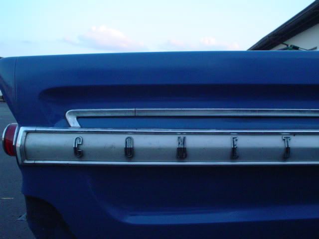

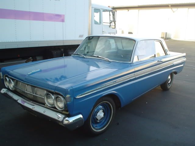

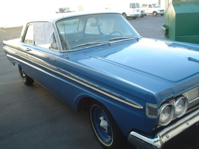

I've been working on this all weekend, lots of work but I think results depend on how much patience and how much effort you want to put into it (like anything else). I'm about to do final wetsand and polish, will post complete results including before shots in "eye candy" section here but here's pics after 3 coats and 1 wetsand:
Don't have closeups yet but I gotta say the pics are a little better looking than in person, I've got a lot of orange peel and some drips I didn't spend the time sanding out, but I'm way better off than what I started out with!

Post #16 by johnnyzoom » Tue May 30, 2006 9:50 pm
Yeah it's tape, it came off easily considering it was about 95 degrees out...
... But it's going to have to go on again, unless I can find a way to keep somebody 6 feet away from the car at all times, or only take it out at night, in which cases it looks great!
I have a lot of sanding and repainting ahead of me. I didn't wetsand enough or properly on mine, too many roll marks in the light on hood and trunk lid, sides aren't too bad. Color is actually darker royal blue, and it is nice and rich in general. I'll keep at it...
johnnyzoom
Posts: 124
Joined: Mon Jan 16, 2006 11:40 pm
Location: Tampa, FL
Post #17 by johnnyzoom » Tue May 30, 2006 9:51 pm
So here it is $75 and a bad sunburn later -

Post #46 by falconfsc200 » Sat Nov 04, 2006 3:25 pm
I have used rustoleum on a couple cars, granted i opted to use an HVLP spray gun instead of the rollers, simply because i have one.
Metallics are possible. Use rustoleum "aluminum" color. Did a VW Fox that way. Any color you can dream of is also possible.
I have 24 dollars in materials for the paint on my neon, the Fox was 32 bucks all told. I used sail blue, carnival red, black, and aluminum to get a color that almost exactly matched the original color in the trunk of the car.
I apologize for the terrible pics, my camera isn't the greatest.
