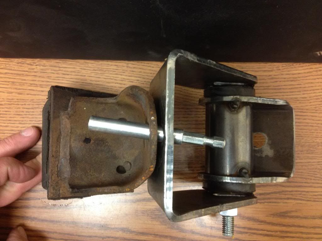

Small Six Motor Mount Dimensions

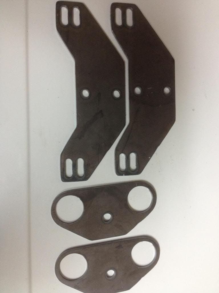

Fresh cut plates
Where the plates were supposed to be bent, my first set are off just a little bit..

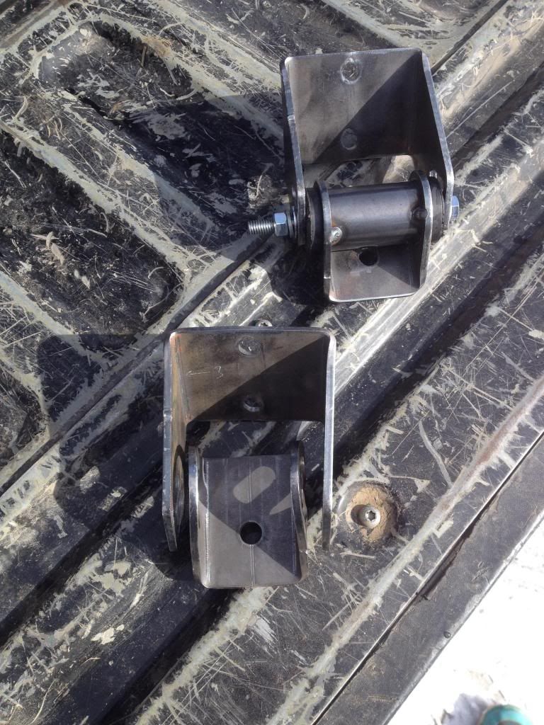

A set of brackets one without the bushing tube, and a complete setup for one side.

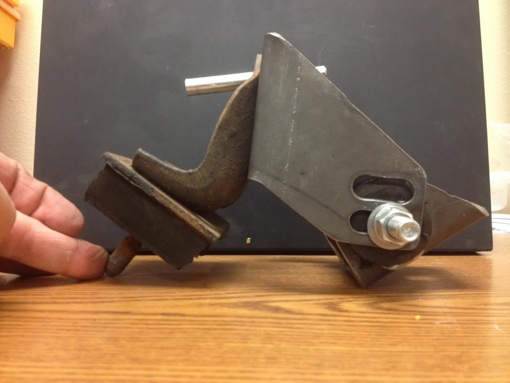

And back to back with a stock mount.

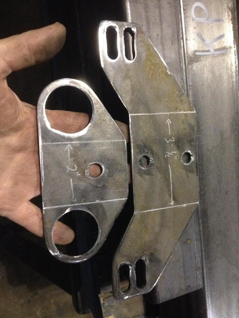

Eccentric Eliminator plates.. buening provided me drawings for that too..
'67-70 Mustang

Adding some images so I don't forget where this project is... It's currently buried in my garage... :bang:
- Perry
