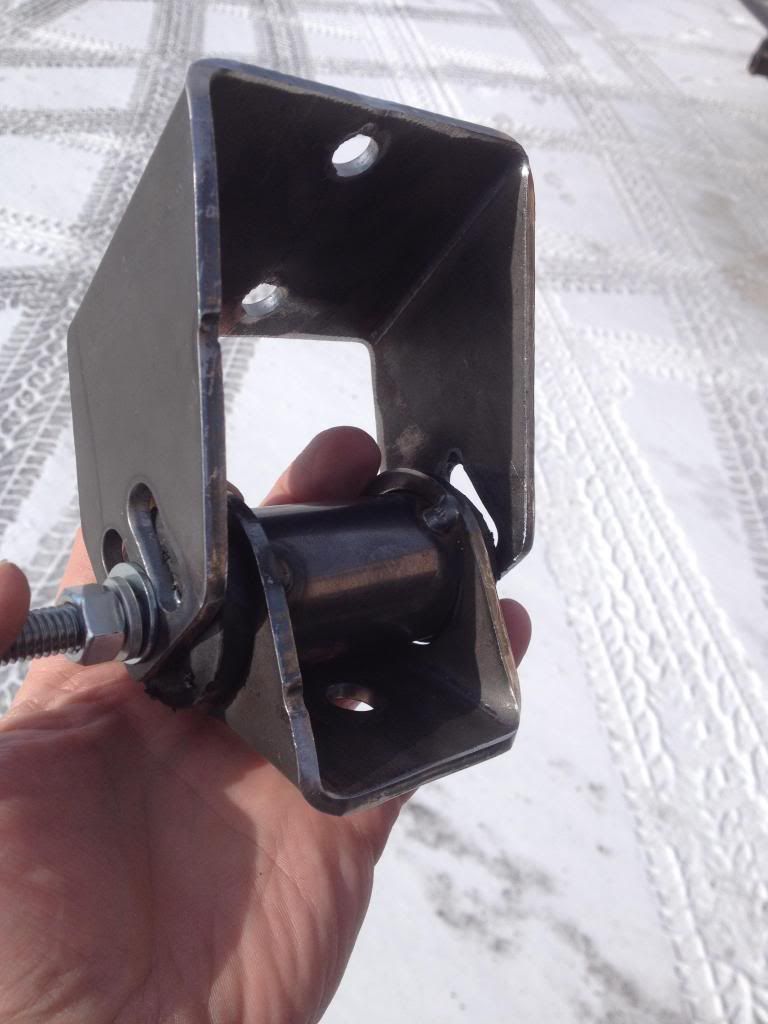

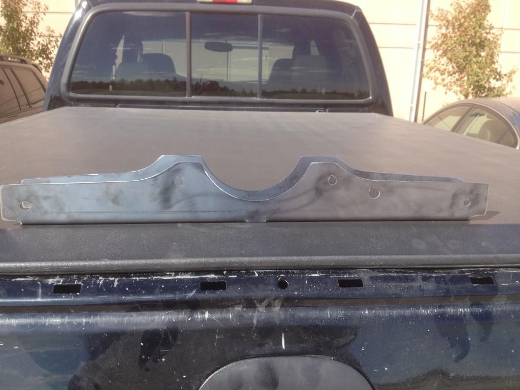

Notice the big dimple in the engine crossmember to clear the clutch cable.

Quick update: Crankshaft oil scraper cut and ready to go.
First image is of the template...
Cut from cardboard with scissors.
Transferred to metal and cut with jigsaw and dremel.
I'll start working on the oil pan next, then finish the head.

Re: 1984 Ford 2.3L powered Bronco II
That looks nice.
FYI, if there's ever anything like similar to that, and you need it in higher quantities, let me know..
I make stuff, CNC plasma, low quantities at work.. (as long as it doesn't interfere with my real job...)
flat plate
bent into a crossmember (early falcon T5 swap -- designed by SoCar72)
keep me in mind when you start thinking about motor mounts.
The bigger of these two brackets might bolt to your block, I'm not certain how many or which dimensions 2.3 and 3.3's share, just eyeballing your block they might be close.
Small Six Motor Mount Dimensions -- FordSix Forum
flat plate

The junkyard yielded mounts from a '94 Ranger. I figured since the Bronco and the '94 Ranger were both twin traction beam, the crossmembers would be the same. They were close, but I ended up over sizing the hole in the mount brackets, slid the engine around until it was happy, and tack-welding washers to the brackets. Removed everything, and final welded the washers.
I'll paint the Bronco gray with a red stripe, so the engine ended up in similar colors. I had a long tube header left over from my Pinto project. I was hoping it would fit the Ranger, but #3 tube wanted to occupy the same space as the evaporator plenum. I went back to the wrecking yard and picked up a Ranger shorty to run for now.
