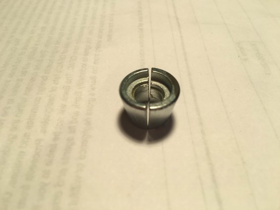

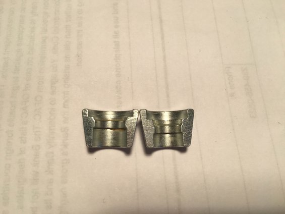

Hey everyone, putting together my head after milling and some port work and ran into trouble with a keeper. Surprised I didn't notice it earlier but one and only one of my valve keepers is incorrect.
One on the left is the odd ball
Anyone know the manufacturer/part number that was used for the aluminum heads or the specs so i can order up a new one? I know they're 5/16" stem but not sure on the degree. Thank you!

They look like the average run of the mill stock replacement 7°lock used in any Chevy, Ford or Chrysler 11/32" valve stem. They are nothing special or custom. The oddball one if used in a matching set changes the installed height approx .050".

CNC-Dude wrote:They look like the average run of the mill stock replacement 7°lock used in any Chevy, Ford or Chrysler 11/32" valve stem. They are nothing special or custom. The oddball one if used in a matching set changes the installed height approx .050".
except they are 5/16, not 11/32... but they are 7 degree

So it turns out the keepers are actually 10 degrees on the ones I got with the head (I learned the hard way).
