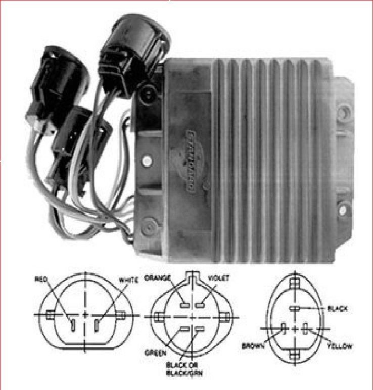

I'm trying to find information on the 'right way' to wire up a yellow strain Duraspark II ignition box.
This box would have been used in 79-81 Mustangs with the carb turbo 2.3L i4 cars.
I can find the diagrams that work for blue and red, but not yellow.
I'm working on an old school method for how to retard timing underboost.
The normal blue/red boxes have a built in 5 degrees of retard when the white wire is engergized, the yellow has another 2 degrees via the additional plug.
So what am I actually trying to find?
This is the 'normal' wiring that is easy to find.
White Wire - Start Terminal
Red Wire - Run Terminal - 12v Battery Positive through Ignition Switch
Purple Wire - Input Signal Negative from Ignition Pick-up Coil
Orange Wire - Input Signal Positive from Pick-up Coil
Green Wire - Ignition Coil Negative Terminal
Black Wire - Battery Negative - Ground from Distributor
These extra wires, I'm trying to track down their intended use and voltages. (black seems obvious)
Yellow Wire - Run Retard Program Line Return
Black Wire - Run Retard Ground Terminal
Brown Wire - Run Retard Program Line
Am I overthinking this?
Do I just hook yellow to one pin on a pressure switch and the brown to the other?

I left out a few details.. I had looked at those diagrams already, and they are only good for NON-turbo cars.
Here's the pic for the 1980 ignition where it only shows 2 connectors, yellow strain has 3.
Here's the rest of what I've looked at, I left it off because I thought it was getting too long.

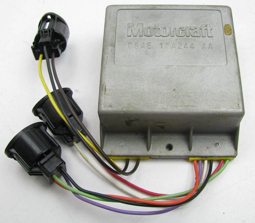

[QUOTE=8T6 SVO;1142813]I've got what appears to be a early 2.3 turbo motor ignition module with solenoid.
Can anyone tell me specifically what this part is?
There is a tag with the numbers EOSE-CIA and the module has a
D8AE-12A244-AA on it.
The part looks to be never used, but stored poorly for many years. I have no use for it and thought maybe a Pace car or Cobra car some where might have a use for it.
So - I'm trying to ID it, and get it to the right person.
Thanks in advance!
[/QUOTE]
[QUOTE=gr79;1143121]The box looks to be a DY-237. There were AA and AB (237A) versions.
Both have 3 connectors, 2 yellow strain reliefs, 3 wire 3rd plug.
For turbo, non-turbo apps.
Switch setup shown modifies spark (retard?), non turbo, car/truck.
Was something like for high altitude, carb. Exact engines it was used with-??
Turbos had additional switches similar to one shown.[/QUOTE]

bottom pair for ignition timing control.
Each pair consists of one high and one low limit switch.
Assy. is connected electrically to one plug of the 3 plug DY-237-A ignition module (yellow strain)
Image[/quote]

Post #10 by xctasy » Sun Jul 22, 2018 9:48 am
Very importantly, the Three Pin Plug wires have been changed after the 1979 model year; D8 and D9 color codes vary.
The module is listed as a Feedback carb option for 1980 250 YFA equiped Granada passenger cars, as well as many others, 10 pages long in fact.
Posts: 6834
Re: Needed Duraspark Ignition wiring diagram or info
Post #11 by xctasy » Fri Jul 27, 2018 6:19 am
Just confirming from gr79 and m81mclaren that no carb turbo 2.3 Fords were feedback, so no need for MCU to trim air fuel ratio.
So your free to experiment as discussed.

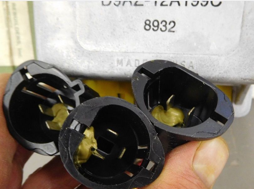

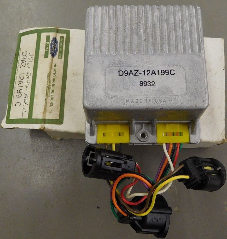

Module:
My 79 2.3T uses a Motorcraft DY-237-A or D9AZ-12A199C module assy.
Two yellow strain reliefs on side. One has 2 wires, one has 4.
No other connections. Two black harness connectors.
Connectors, wire codes to module:
One 2 wire (pink, white), one 4 wire (green, orange, purple, black/green stripe).
The 2 wire connects to the sensors. The 4 wire connects to the distributor.
Only other turbo boost related item under hood is the two level sensor assy on fender.
