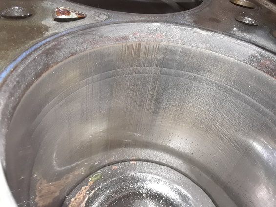

Here's one of the cylinders. They all look like this. There is no ridge at the top, just carbon build up. I measured cylinders 3 and 4 with quality (Starrett) telescoping gauges, and a micrometer. Measured every 45°, 1 inch from the top and 1 inch from the bottom of the cylinders and measured 4.040 every time. The scars feel a few thousandths deep.

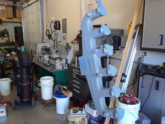

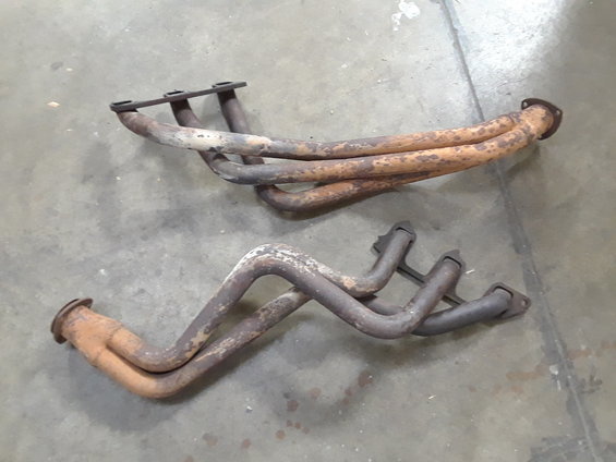

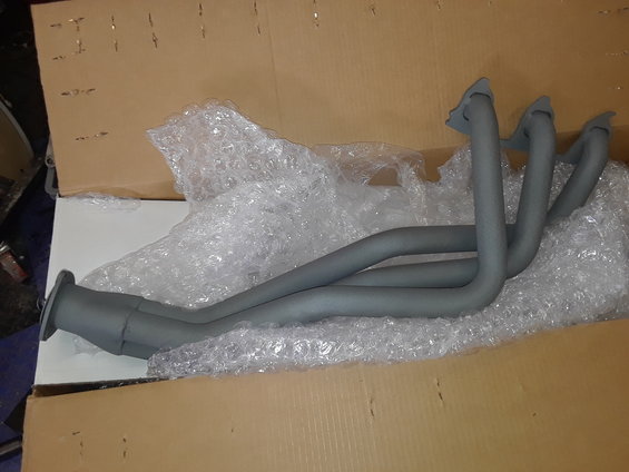

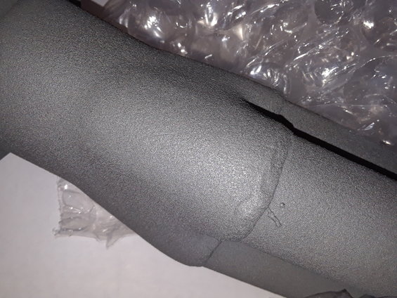

Got my headers back a while ago. Here's where they started.
And after the JetHot cast iron color coating.

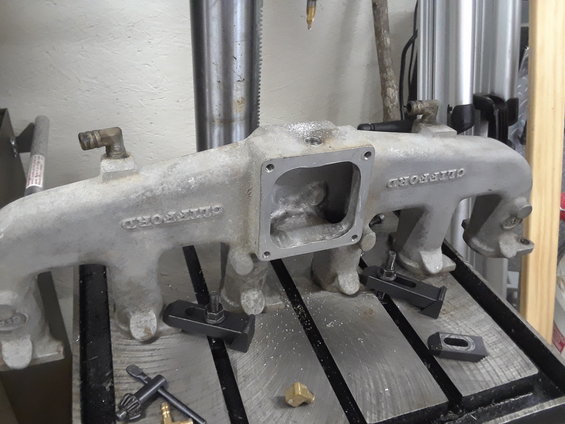

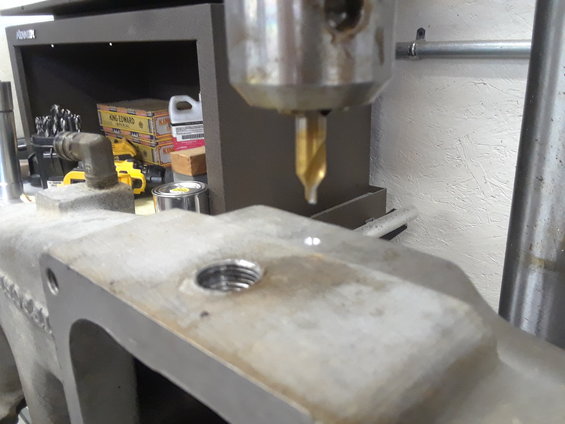

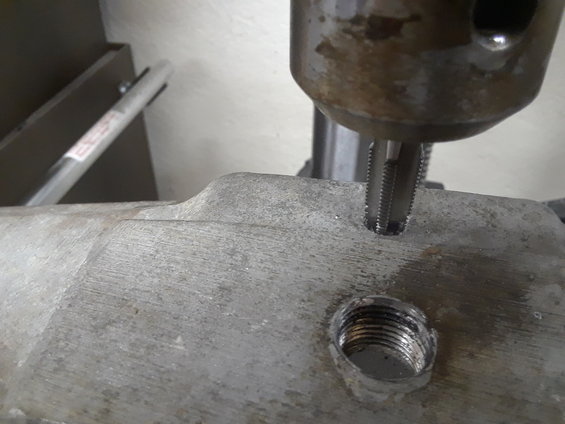

I also did a bit of work on my Clifford intake. Previously it had this huge 7-nipple vacuum tree on it, with only one line going to it. So I swapped it for a single 90° brass fitting. I then needed a port for testing with a vacuum gauge, so I drilled and tapped a second hole for that.
Mounted to the drill press table
Using a #4 center drill
After drilling to size, I chucked up my npt tap, and used the spindle to keep the tap straight. I did not tap under power.
Then I set about painting it.
All masked off
Primed with VHT flameproof gray
Painted with duplicolor engine enamel, in New Ford Gray. Valve cover and side cover will also be this gray color.
1985 Bronco. 309ci I6, NP435, 4.56 gears, Detroit locker and tru-trac, 4" lift, and 37" swamper tires. The 309 is 9.75:1 CR with a Schneider 140H cam, 4bbl, roller rockers, larger valves, and headers.
Posts: 10029
Re: 300 torque build 85 Bronco
Post #28 by bubba22349 » Wed Jun 06, 2018 1:12 pm
:beer: Those are a good looking set of Headers and Intake! :thumbup: :nod:

I have the same intake. I was going to weld up a 90* hose bib for the coolant, but like the ones you have. Where did you find them?
I assume those are Clifford headers. They are nice, however, they will seal in your starter. I switched to a much smaller efi starter to avoid that problem. Also, after using a set of hedman headers for many years, I got tired of the rattles and lack of room. I decided on a set of Clifford shorties, into a single 3" tube for a bit, and then reduce it at the rear with a 2.5" tailpipe.
The heat from the header, even with a shield, prevented using several types of carbs. If you use the header you might want to consider a cool air intake for mpg sake. Good luck.
*P.S.: Are those 1 5/8" tubes on the headers? They look 1.5", but it could of course be the photo.

F-250 Restorer wrote:I have the same intake. I was going to weld up a 90* hose bib for the coolant, but like the ones you have. Where did you find them?
Headers are indeed 1.625 tubes. I just built exhaust for them, so they are staying. I have a quickfuel 450 slayer, virtually nib. It's been a few months since I tore it down, so I can't remember how the starter access was.

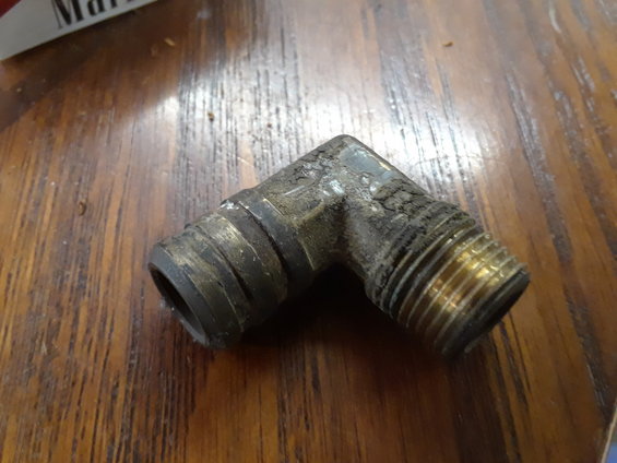

Post #32 by BigBlue94 » Sat Jun 09, 2018 10:06 am
Here's the elbows used for the intake water jacket.
