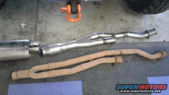

The reason you dont find them is what Pmuller stated. However, you can weld a bung into each collector, and after the cat.
Then, you get the joy of building a y pipe and exhaust. Or paying someone to do it. Was an all day job for me. Longtubes really crowd the passenger side up.
Long tube headers on an 85. Y pipe is 2.5--->3". O2 bung right after the merge. Then a magnaflow cat, borla xr1 and single 3" tailpipe.
Old vs new y-pipe. Lots of small adjustments were made here.
Not much room on an 85 bronco
