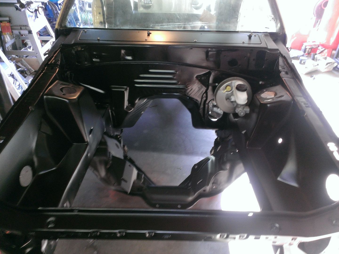

I got a deal on a complete 75 Mustang II front end. Donor was a V8 a/c car. I grabbed the master cylinder and proportioning valve with it. So now I have a couple questions right off the bat. Strut rod mounts. Sway Bar links using Falcon bar. Spring rate-springs have been cut so I'll be getting new ones.
Thanks Rich

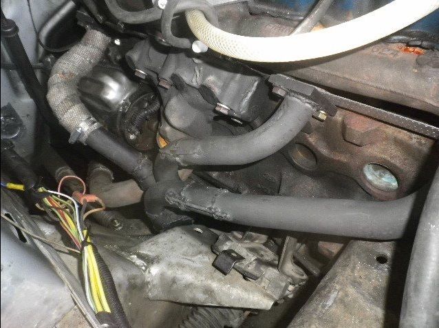

fast64ranchero wrote:Well I haven't said much in here in some time, and some of you might remember my project that has turned into two year, for the rest of you here's the short version, 250 offset ground crand to 4.125" block bored to .037 over, Manley rods, CP pistons, Clay Smith custom turbo cam, Turbonetics 62-1 turbo, now if I can get the pictures loaded on here you all can see it mated to its tranny (TKO 500) if all goes well it's going in my Fairmont this weekend :lol: Image
Image[/img]
and yes I do have one of Mikes heads, but no intake so my mill'd head will have to do for now :twisted:

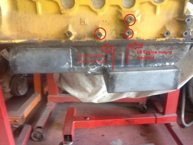

Post #9 by xctasy » Tue Sep 18, 2018 2:47 pm
cobraguy wrote:I'd love a couple pictures of that oil pan.
Sure, we do "couple's therepy" here.
Here's another view of Fast64Ranchero's 250 in Fox square sump. 1+1= "a couple"
http://fordsix.com/forum/viewtopic.php?f=22&t=52695
Not the oil pump "kick out" common to all in line six 200 Foxes from 1978 to 1983.
You can use Briggs and Stratton fuel tanks to do the same thing.
Like non standard 351 C to Fox frame Ford swaps, you can external mount the dip stick tube to avoid drilling the block to relocate the dip stick. Fast64Ranchero did it Early Bronco/ Canton Fox 351c sump style.
The 250 SBF block pattern is the same as the 302/351, so you can use the same profile for a 351c into Fox.

xctasy wrote:For sump, contact Mike1157.
Pick and mix through Mikes work, and copy his parts inventory where required.
http://vb.foureyedpride.com/showthread.php?155706-The-path-less-traveled-1978-Turbo-I6-Futura-%28The-Gila-Monster%29
I can send you some parts, but my kit uses the Aussie X-series engine mounts on an engine that is an inch narrower than the US 250, and the sumps are not the same. The Aussie block is half US 250, half US 200, so little that fits a Aussie 250 into a Fox body will benefit a US 250 Fox.
Sump needs to be custom modified to become a 200 sump at the bottom, and you need to copy the pickup shape. At worst, you can go nuckin futs with a MIG welder, and you'll get a result that will work.
Or you can do a little more networking. The oil pumps aren't the same. What Ford US did when the 250 came out, they dropped the oil pump down the stroke throw length increase 0.392"), which is why the 5/16" oil pump from cam drive shaft is so much longer on a 250.
You can do lots with the oil pump position on 200 and 250 sixes,
http://fordsix.com/forum/viewtopic.php?f=1&t=72783
Mike eventually made his external, and revised the sump below.
Mikes looks great. The alternative is to cut and shut the Maverick sump like Jack Collins did.

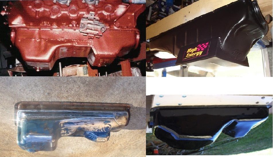

JT81Stang's 250 Fox
http://www.fordsix.com/forum/viewtopic.php?p=359266
use the lower half of the original 200 pan and the upper half (including where the front & rear main seals go) from a 250 pan.
He screwed the upper half to a piece of plywood to minimize warpage when welding the two pieces together.
As for a dipstick tube - it went into the drivers side of the pan just below the mounting flange"
He used 1971 Maverick 250 motor mounts which lower the motor in the engine compartment. You can use the original 200 mounts but the 250 will sit higher
Mike1157's US 250 Fox bottom left
Jack Collins Fox2503vpan top left
James Dinga's 200 Aussie X shell top right
vs vs 1972-192 Cortina 200 and 250 Six bottom right

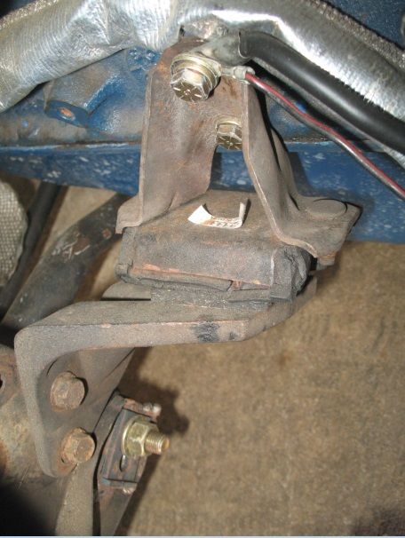

The I6 engine mounts vary in position. Ford changed to Center percussion in the 1969 Mustangs, moving the engine mount forward.
The common F150 4.9 "Motor mount" (aka, the rubber part) was used in some of the 3.3 Foxes. Its a great pickup for mounting a 250, as Dayman found.
With the 1968 incorporation of the 250, and the movement of the 170 or 200 into the Early Bronco, Ford started adding "bits and bobs" to the ages old 144/170 block casting base the 200 and 250's used.
The block transfer lugs allow a later model engine mounts (the metal hardware) to be repositioned.
Early small six Fords were all mounted back from the later center percussion mounts.

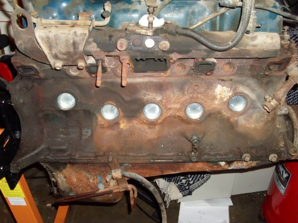

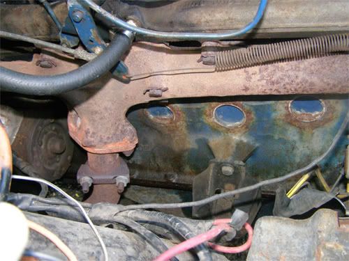

Post #12 by xctasy » Tue Sep 25, 2018 5:02 am
Yeah, its 4-1/8 " uniform forward in the Foxes for the I6. Or "about" one bore spacing of 4.08" I believe.
The second to third from front frsot "welch" plugs show the difference between the 200 and 250, but you have to measure back to the bellhousing mounting flange to get it exactly.
The I6 block to V8 mount centriod is about 4-1/8", or so generally. Any Fox I6 to Fox V8 comparison shows the distance. The Australian engine mount was devised to stop the engine falling on the road in billobong or washout ridden roads in Australia. It was not uncommon to find foot deep trenches in areas of yumps or arond corners. Ford decided they were going V8, but they decided to repostionthe engine mounts back to the V8 position. The engine mounts generally are a straight measure off the transfer lugs. Grab a SBF, and any small I6, and you can work out the spacing difference. The US scenario was quite different to the Aussie V8/I6 common mounting pads on the cross member. Although very similar, the US small six was downgraded untill the US 250 forced CenterPercussion engine mounts, but not evey small six got them, so they vary quite markedly.

Update: I have the boxing plates made and the driver side is boxed. I'm doing this install at an adult ed night course so I only get to work on it Monday and Wednesday nights 6-9. The school has all the fun toys so the trade off is worth it. I also can easily figure how many hours went into the swap. I got a bunch of new parts for my birthday, manual rack, tubular UCAs, springs, 2" drop spindles, steering shaft and u-joints. Shameless plug to SAE Speed in Corona Ca.

Left side new stuff

Re: Mustang II isntall
Post #18 by cobraguy » Fri Feb 01, 2019 1:41 pm
Making a rear sump 250 oil pan
Measure a lot
Make a template
Build it
Make it fit

Posts: 9305
Post #19 by bubba22349 » Fri Feb 01, 2019 3:11 pm
:beer: Looking great! :thumbup: :nod:
