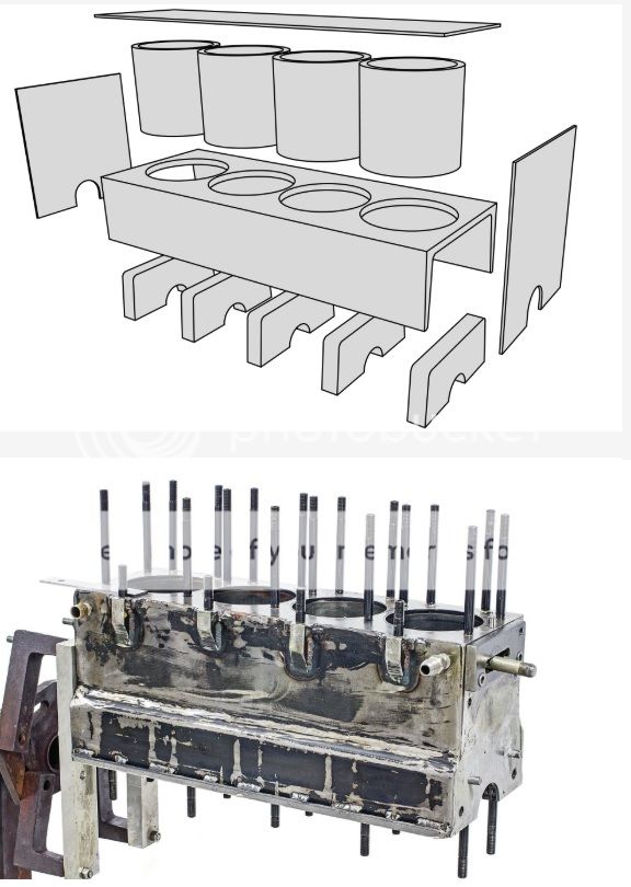

While we are on this topic check this out https://www.hotrod.com/articles/how-to- ... al-engine/
This guy got tired of modding inadequate stock parts and just welded and machined his own 700 HP 4 cyl OHC engine.

Bob St Lawrence got sick of blowing up early Hemis, so he built his Own Block, and arc welded it together using boiler tube and metal plate. Pre heated, and had welded by Tab contruction. He became the turret mill.....
xctasy wrote:Do it yourself!
Image Image Image Image Image Image

As for cylinder heads, Aussies were doing it with tooling plate alloy stock in the 50's and 60's.
Twin Cam cylinder heads

some out of spec BB pistons
beyond spec sleeves and diesel crank
and a bunch of damaged beyond repair BB heads to section and weld together
to build a 400" + stroker with minimal cost except for machining and time invested
pretty much all that is listed above could be bought at scrap price or scavenged
It might be possible with the correct collection of discard parts to do this fairly cheaply.
I need to find an industrial engine rebuilder and go spend a few hours groping over parts to see what might work
otherwise fabrication of a complete engine from welded components might be easier
that article about the head the guy cast as tops and bottoms is interesting
that would allow the same comb chamber to be used and different cam layouts
(in block, SOHC, DOHC)
Clive

hairyclive
Posts: 21
Joined: Fri Mar 29, 2019 1:44 pm
Re: Has anyone ever built something like this?
Post #39 by hairyclive » Fri Apr 12, 2019 4:54 pm
by swiss cheesing the block
offsetting the bores and using some diesel wet sleeves machined and siamesed it might be possible to go up to a 4.7" bore.
and leaving .200 walls
offset boring across the block could make the thrust side thicker than the coast side
leaving about .250 thrust .200 sides and .150 on the coast side
OK
using the number you gave at 28.5 deck length
it looks like the same process I described would be able to make the block with 4.63 (same as FE) bore centers
4.63 bore centers adds .75" to the length of the piston separation from #1 to #6
this should be possible on a stock style crank
allowing 4.5" bores (lots of catalog pistons here) with .180 in the siamese walls and leaving .200 on the end cylinders
makes the length of the siamese unit 28.3"
pretty tight stretch leaving the block almost separated at the top after boring
but was looking at possibly installing some spliced tunnel port heads they seem to be easy to find
I started with a 5" sleeve to cut down to allow a desaxe style engine with the bores offset towards the crank rotation across the deck,
(reduced piston loads and frees up power)
but the only way to do this to excess would be use a reverse rotation cam (there may be one in the marine catalogs)
as the cam is on the wrong side of the engine to allow much offset
*** or remove the cam entirely and use a few blown up SOHC 427 heads to make a SOHC HEMI 6 ***
( and lots more problems, finding, welding, line boring, custom cam, etc. or maybe talk to Dove Eng, or Coons or another about a
custom casting and a lot of money changing hands )
there might even be a market for a conversion kit if enough were made to make the price decent
with 4.5" bores and a 4.5" crank that gives 429 cu in (5" gives 477)
at 6500 rpm this would need about 1000 CFM airflow with decent heads and ports in the 350-450 CFM range
and maybe 6-700 HP if the parts stay together
would be in interesting visual and audio symphony
and an entirely efficient way to spend a hundred or so hours of machining and assembly time
would be really cool with FI, (anyone know if Holley has a computer yet that can run 3 x 2 bbl injector bodies), Webers, Dellotos,
or maybe a couple of Autolite Inline carbs http://www.inlinecarb.com/
(maybe a pair that have a damaged barrel on one end could be found cheap)
If I had access to a shop now and a pile of unallocated cash I am really tempted to try this out

pmuller9
Posts: 3558
Location: Columbus, Indiana
Post #42 by pmuller9 » Sat Apr 13, 2019 10:26 am
You should use at least a 7.0" long connecting rod in which case the block deck would need to be extended.
You could consider oven brazing a new block deck to the old deck that has the correct head bolt hole locations and water holes.
