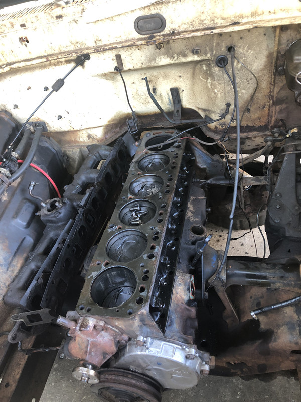

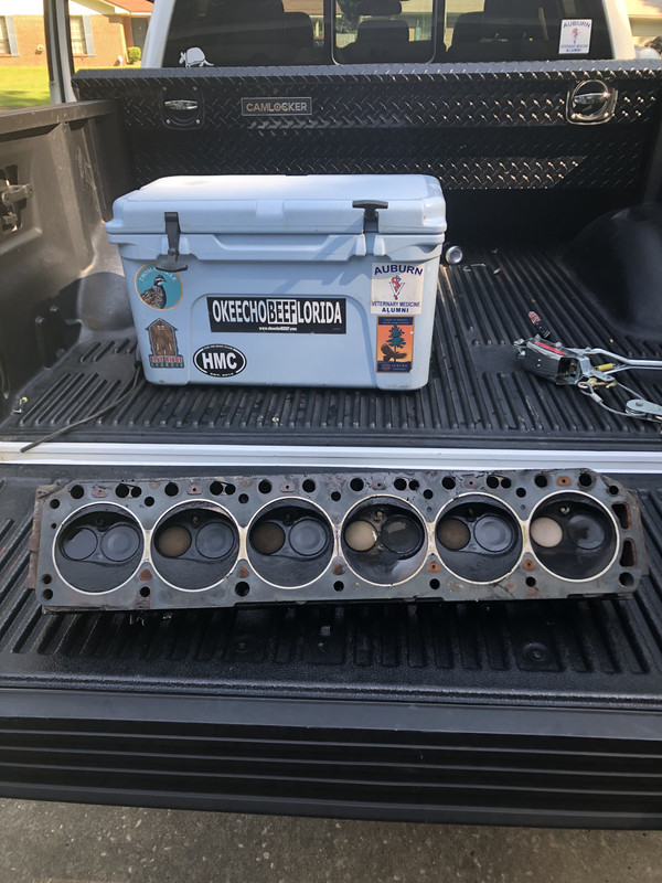

Well only took a few months but I finally parked the truck and got the motor out. Disassembly was pretty much uneventful, once I had made 37 trips inside to my toolbox. Took me the better part of a day working by myself and labeling and bagging everything. Pistons badly carbon caked, looks like number 4 and number 6 took the brunt of it. Number 4 piston was burned, number 6 not quite as bad. Cylinders look really good to the naked eye. I couldn't find my puller to get the balancer off so haven't got the bottom end apart just yet. More (and better) pics to follow.

Any idea why 4 and 6 were so lean? 1 looks wet...

One was wet. Had oil leaking from behind the exhaust valve what I could tell. No idea about four other than maybe losing compression. Deposits everywhere, even visibly holding the intake valve open. Lots more pictures I will post tomorrow. But if anyone can tell me about the rods going from the plugs (literally rods off the plugs) going into the exhaust port on this head I’d love to know. That’s a new one on me. I will also post pictures of that.

Yeah those 4/6 exhaust valves look burnt, did you do a compression test before you pulled the head? Maybe the cam lobes are worn, causing less valve lift, possible not drawing enough a/f mix into those cylinders? I don’t know, but usually 3/4 are the richest on the carbed heads I’ve pulled, with 1/6 looking slightly leaner, but certainly not white exhaust valve lean...

Well, I believe I found the culprit on 4 and 6. The porcelain insulator on the plugs was cracked, leaving visible carbon tracking as the spark leaked out to ground on the head and not through the plug. When I touched the insulator, it fell off.
Here's the plug for 4. 6 was not near as bad.
Head on 4
Piston on 4. I was told one piston was replaced. I assume this is it. The STD give evidence to the notion the block has never been out of the truck.
Cylinder wall on 4
Casting Number of 8C25 makes sense for original motor. Truck was built late April, 1968. Head date code was 8C22.
These are the "rods" coming off of the plugs going into the exhaust port. They're in every port, some eroded worse than others.They are extensions off of the six square headed plugs on the manifold side
