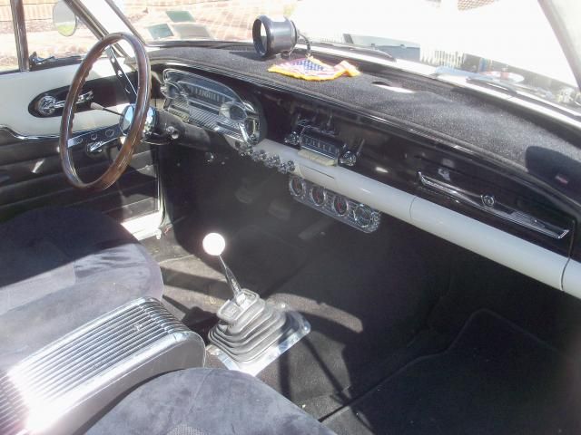

Re: t5 install in a 61 chero help
Actual position with MDL front shift position in my 65 Ranchero. Without the tail housing you're going through the crossmember in the car. Check the thread about the install of a T5 in a 65 Falcon, should be the same. There are more pics on that thread. I'm using the same setup you are except a different model of T5.

... put a Fox Mustang T5 in my '63 4 Dr Wagon with a bench seat. Although my feet reach the ground, I'm on the short side of the size chart. I have no problem with the stock Mustang shifter position except the tranny crossmember is in a particularly bad location exactly where the shifter box winds up.
I did need to fab an adaptor to move the shifter forward to clear the top part of the bench seat in the position I need it - forward, but the shifter is in the perfect ergonomic position .

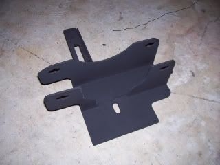

The DS hump crossmember situation can be remedied in a number of ways. My approach is to use the availablqe C4 "conversion" mount modified to fit the T5.
A simple option is the widely available "C4 Conversion" tranny mount for 62-65 Falcon/Comet. The T5 shift box typically interferes with tunnel arch support and needs cutting away and degrades structure integrity. A simple setup with the "C4 Conversion" is to extend across to frame connectors to tighten drive train.

That's the odd ball thing about my 61. It's based on a 60 chassis. I don't have that crossmember, my transmission crossmember bolts from framerail to framerail. I do not have that drop out section.

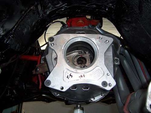

Anybody have tips for installing the t5 adapter for the bell housing and dealing with the two holes you have to drill.

Adaptor plate I used -(CJ Pony) 6 bolt SBF to T5 fits the C7ZA bell but lower left fastener falls on the edge of BH. Adapter is made for Toploader BH apps' but not specifically for the 3.03 - C7ZA 200' BH. It needed the BH drilled and adaptor tapped for that location. I was able to move fastener location slightly up and drill through the thicker "outline" area of the BH,then tapped the adapter's plate and bolt (3/8") from the inside of the BH to the plate.

Got my bell housing adapter installed. I'm actually using a c6 bell from a bronco, cast iron. The recommended adapter from pony car worked flawlesslly. Didn't have to drill any extra holes just changed out the two bolts on the inside of the bell housing for socket head bolts and a little carful grinding and fits flawlessly.
Measuring places the shifter at a comfortable spot and very sporty. Very tight to the bench and I now have a set of first gen mustang buckets(testing) and the fit of everything feels right.
