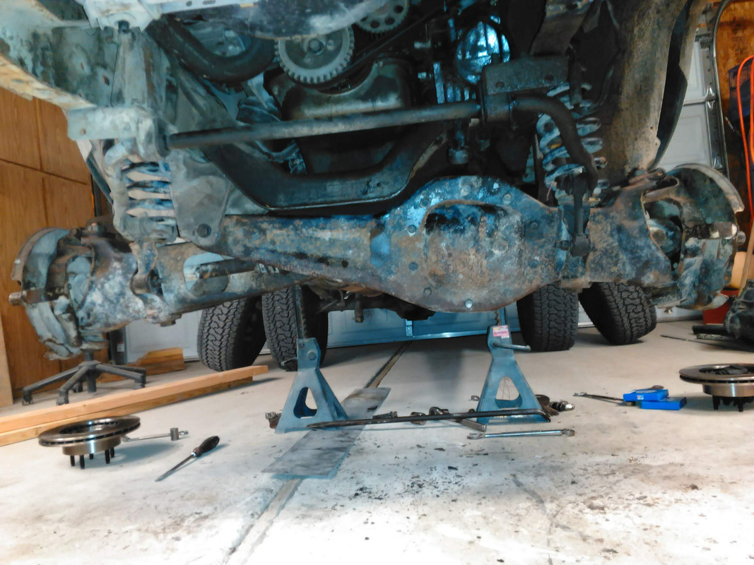

Much to catch up on. Axles, paint, and forced induction.
Rear axle is an Explorer Sport Trac 8.8 rear (31 spline) and front axle is Explorer Dana 35 TTB.
Ratios are 3.73:1. Needs to be ~4.88-5.13:1 to make 5th gear useable. I'm waiting for the turbo installation to chose ratios.
I'm hoping the disc brakes will hold the axles in in the event I break an axle 'C' clip hat.

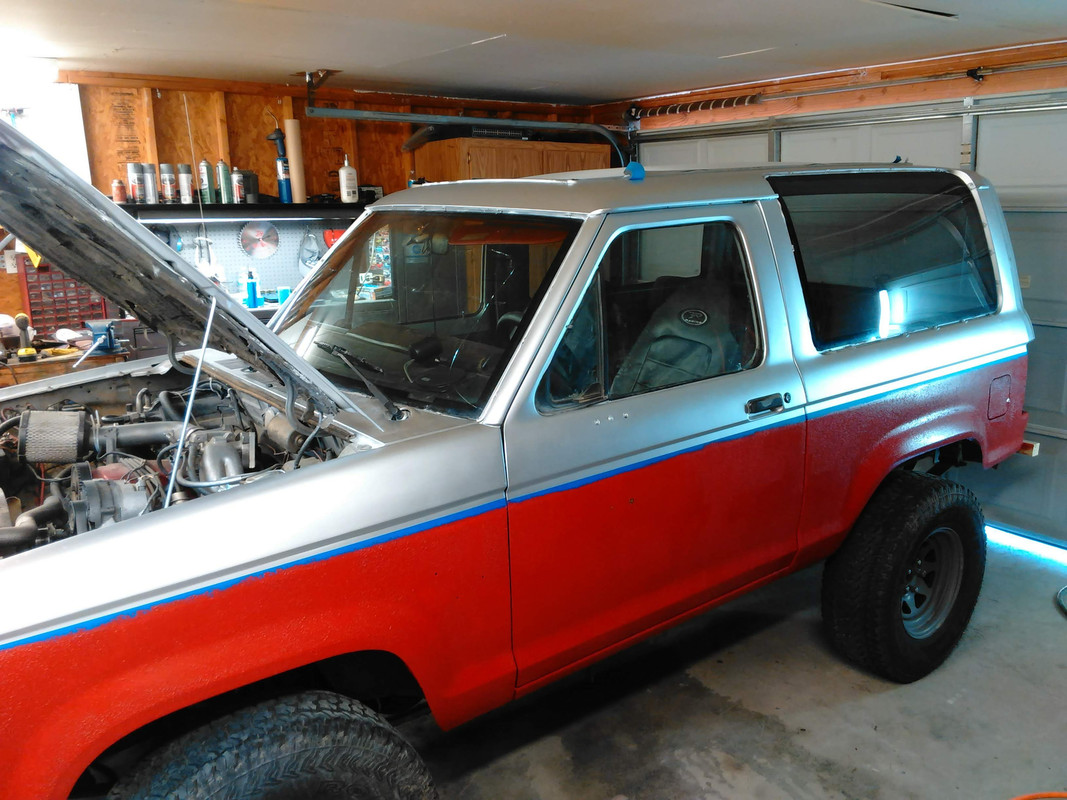

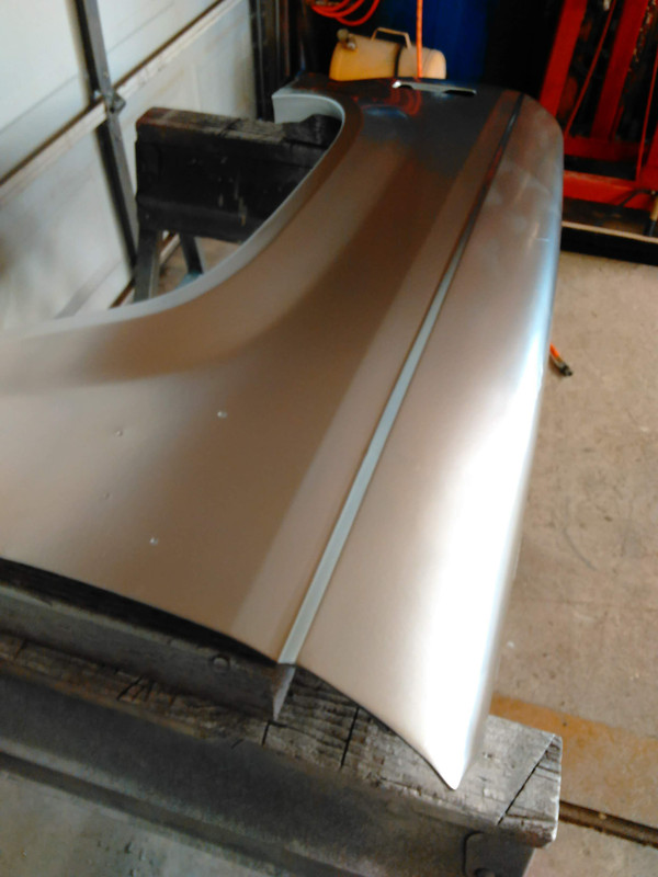

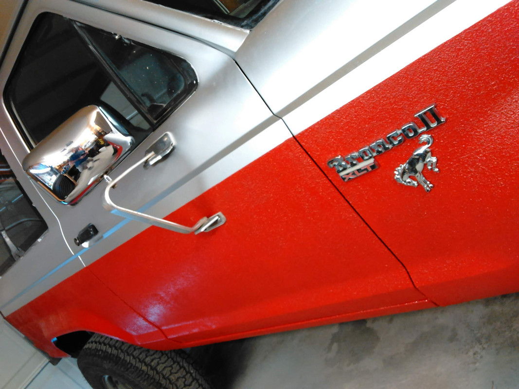

I decided on two-tone Rustoleum/bedliner. The Rustoleum will make scratch repair a cinch, and the bedliner on the sides helps prevent it.
The bedliner is Brick Red Durabak and I highly recommend it. Rolls on with a 4" roller.

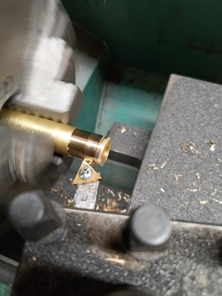

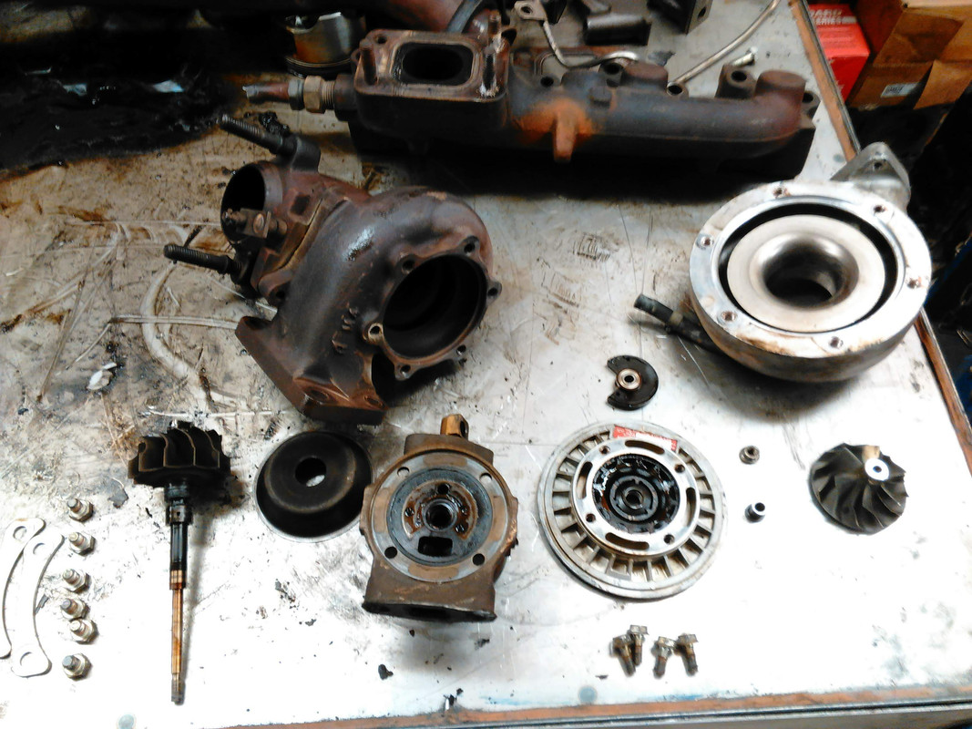

I rebuilt the turbo. It took two tries at getting the correct bushings. The housing was machined oversize during a past rebuild.
-It's a generic Garrett T3 off a Turbo Coupe.

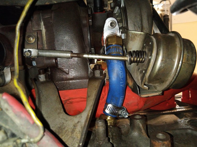

The stock wastegate is set at 10 psi. Wastegate-controlled boost pressure is set by the tension of the wastegate spring. Fancy wastegates allow the spring to be changed, I chose to oppose the internal spring with an external one.
Rig for checking wastegate opening pressure...
Hoping for 6-7 psi when I'm done. That should be good for at least 35 HP/45 ft-lbs, hopefully on 87 octane.

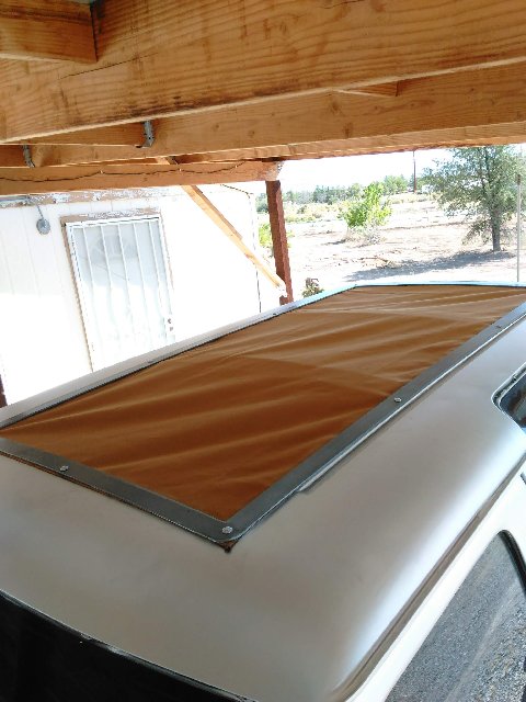

I almost cut the top off last summer. That would have required a custom soft top, out of the budget. I decided to get rid of the leaky sunroof and add some open air ability by installing a canvas roof.
I supplement it in the winter with hardboard under the canvas, but even with the canvas only, it's leak-free.

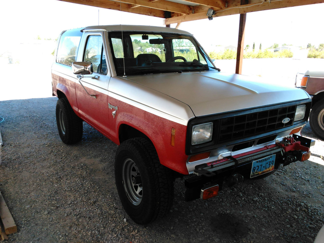

A Bronco in it's habitat, miles from asphalt...

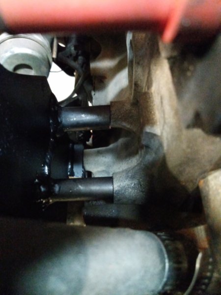

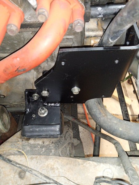

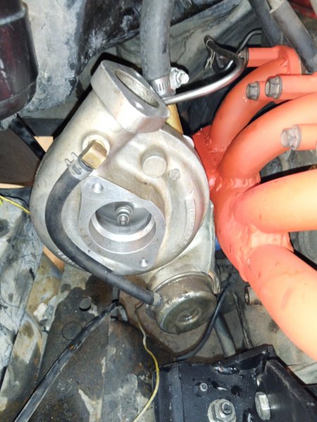

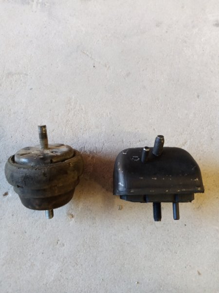

The right side engine mount interfered with the wastegate of the turbo. The fluid-filled mounts and brackets set farther rearward than the older-style mounts, so I made a switch. I incorporated the mount bracket into the A/C compressor bracket.
Imageupload a pic

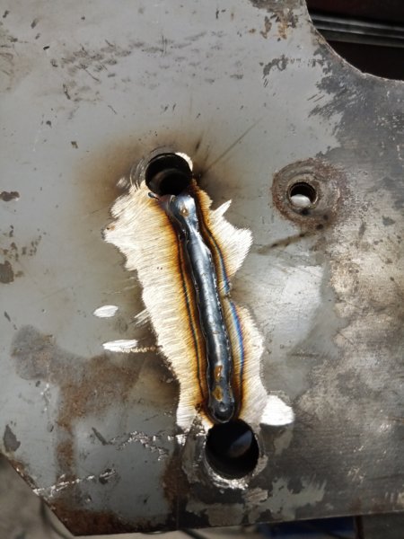

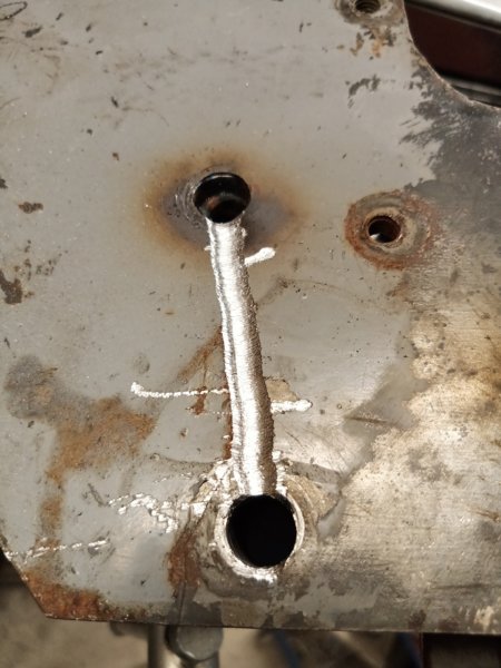

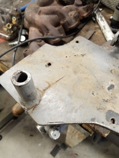

The A/C bracket had developed a crack. I welded it up and added an attachment point.

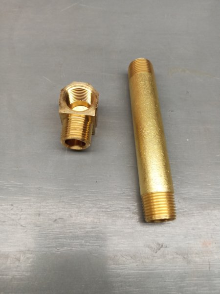

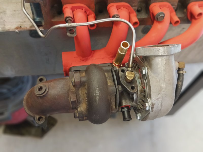

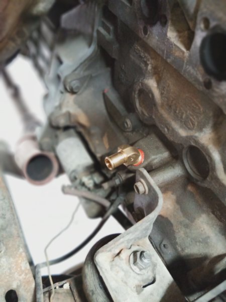

Coolant plumbing...
Oil plumbing...

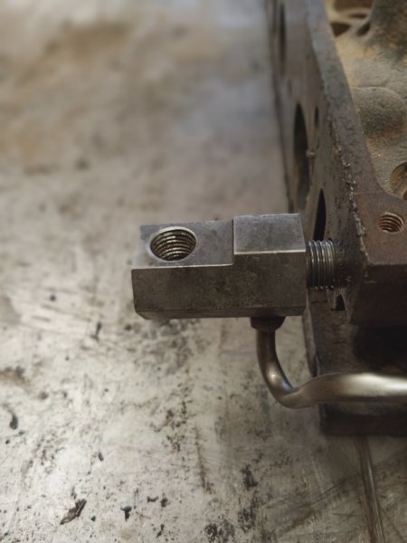

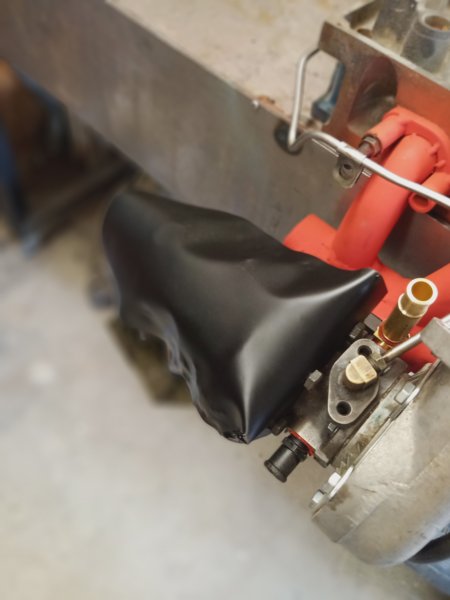

The drain is 1/4" off the manifold, which worries me. I may have to slide insulation over it.
The turbo is about an inch below the plastic evaporator housing. A heat shield is necessary to prevent melting the plastic.
Started it up to check for leaks. There is no downpipe attached yet, it's amazing how quiet the turbo makes it.

The T3 turbo flange is 3/8" steel.
The tubing is 16 gauge 1 1/2" mandrel bent exhaust tubing.
I installed the factory turbo brace under the turbo down to the block. Hopefully that will keep it from cracking.
Stock cam, aluminum cam gear
