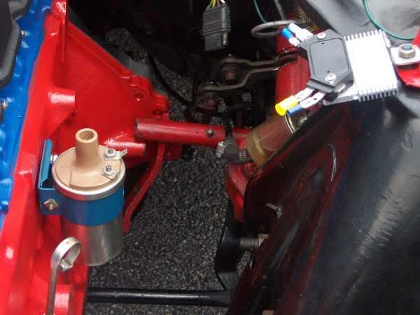

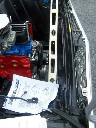

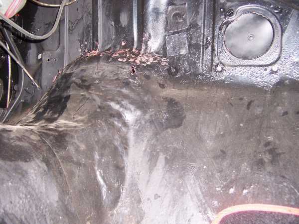

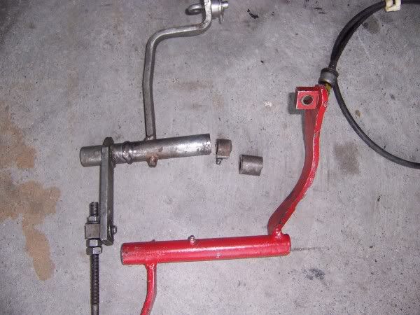

250 install in '61 (Comet) fits ... but with a few issues :
( most were addressed in the Schjeldahl bros' book )
1) The Radiator clearance is very tight. (Look into Pusher Fans)
2) For stick tranny, clutch Z-BAr is too long and it needs to be shortened in the middle.or 63-65 V8 bar .
3) Engine sits slightly higher than needed except oil pan needs clearance to center link.
4) 250/V8 Bell and rear of cyl. head hit Firewall of the '61. ( Removed engine - and "formed" firewall with BFH)
5) Two related problems - The Starter interferes with the Center Steering Link and the Link will probably hit pan if engine is lowered (Kudos to Schjeldahl Bros' 'flipped' center link and re-reaming reverse taper in Idler and Pittman.)
6) Electrical Sensors, gauges, Charging system and Ignition Wiring are different.
Was 250 swap worth it? , ... every time I turn the key ! ...
250 INTO THE 61 COMET “ROUNDBODY”:
SFI 157 neutral balance-lightened racing flywheel spinning Centerforce Stage II Clutch, T5-Z Cobra 5speed, Short throw Hurst shifter, 8” 3.80:1 TracLoc Posi rear, Shelby sway bars, Traction devices. Mustang front strut bars, Scarebird Disc front brakes, Body subframe connectors, 5 Point Roll bar,, Mustang 5.0 alum. racing radiator, GM HEI Ignition, Perma-Cool elec. fan, Holley fuel pressure regulator, Hooker dual out longtube headers, Smithy silencers, Original tube radio. vacuum wipers and fender mounted GUNSIGHTS ! … .
Powerband 8)
