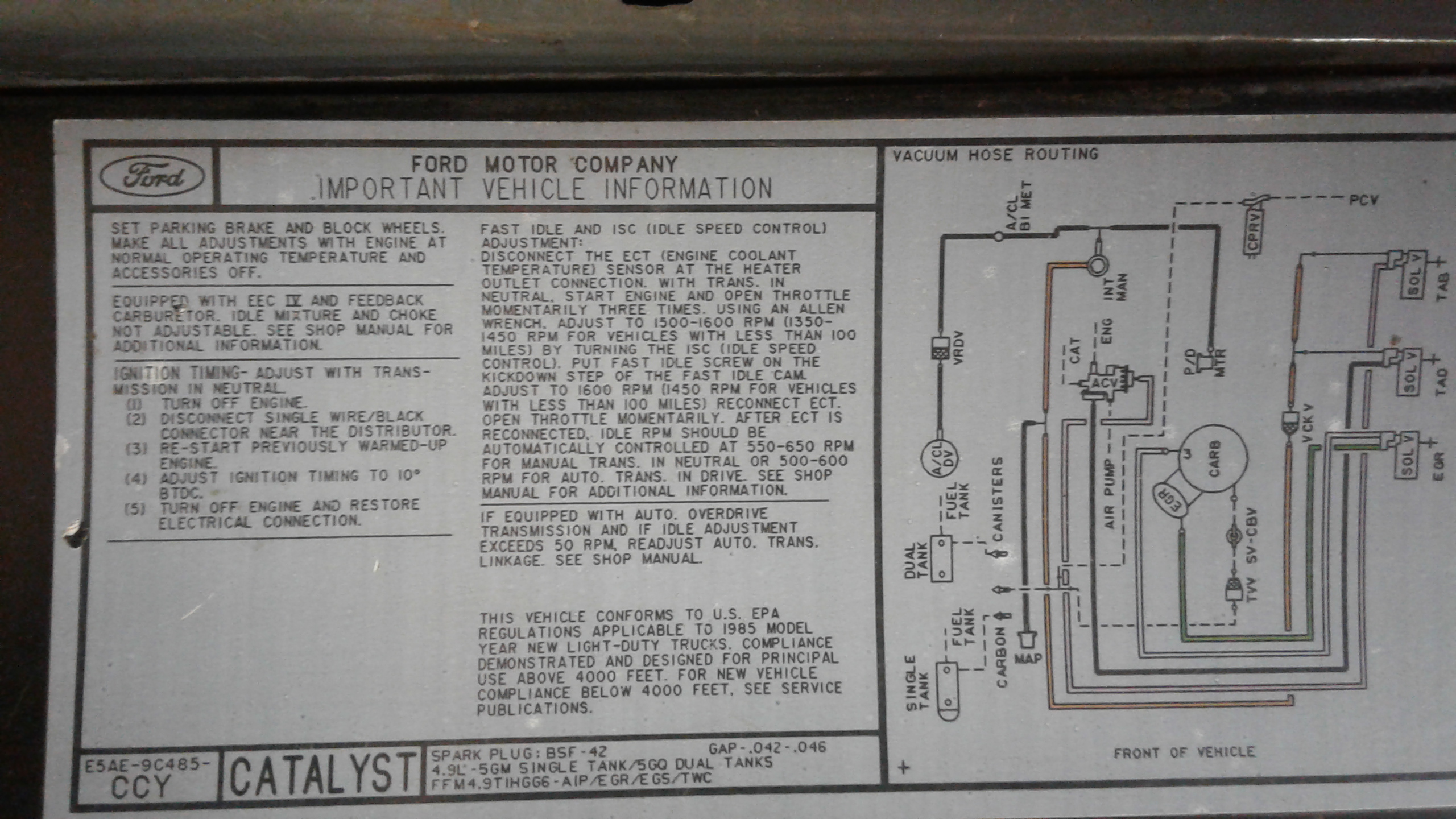

Post #6 by BigBlue94 » Sat Jul 14, 2018 1:28 pm
arse_sidewards wrote:Your '86 doesn't have EEC-IV. It has the EEC-III feedback carb system.
Not sure about this. My 85 had EEC IV stamped on the eec and on the catalyst sticker under the hood.

Post #7 by SteveP » Sat Jul 14, 2018 3:38 pm
My 86 also says EEC IV on the sticker. IIRC 85 and 86 were the only years Ford used EEC IV with the feedback carburetor on the 4.9L engine.
EECIII was 81-83.
