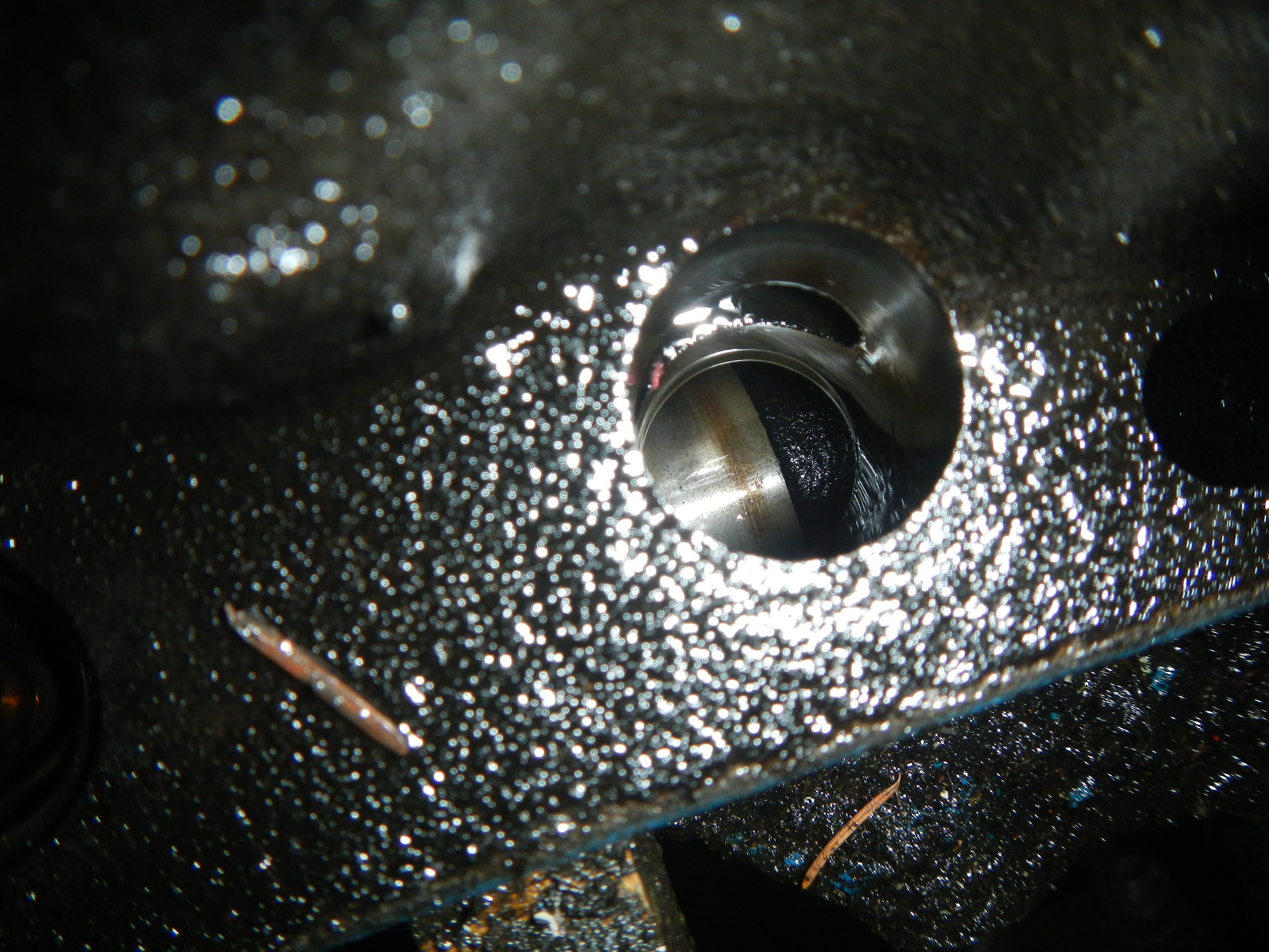

Wish I'd taken photos when I had the oilpan down, but here's the best I can do for a shot of the cam lobes. More wear on one side suggests that its taper is intact, and therefore it's ok?

Best I can tell without seeing it in person but it doesn't seem to show an excessive amount of wear so probably will be all right.

The new ones had a much tighter fit between the body and the plunger, though not the body and the block. They were also dead flat while the old were slightly concave. The metering disks were a different type than the originals, but the old ones were clearly worn. I believe they work by raising the cup off the plunger, and all had been worn pretty much flat.
Details:
Replaced the pushrods (Enginetech PRD360, made in USA) and lifters (Enginetech L900, made in Mexico) and Lucas breakin lube. Fired up and ran at ~2400rpm, according to a microphone/RPM app on my phone. Over the course of about 10 minutes, one by one the pushrods started oiling properly! Oilpressure was 42-48psi with Shell Rotella T4 15W40 at 4C ambient temperature. Eventually the flow got to leaking out the head, so I replaced the valvecover and ran another 10 minutes at high idle. Before the valvecover went back on, all rockers except #3 intake were getting oil. Most pushrods were spinning slowly; two weren't but they were oiling regardless. Next step is to replace the rockers and at the same time check on #3 intake and the non-spinning pushrods.
Posts: 9817
