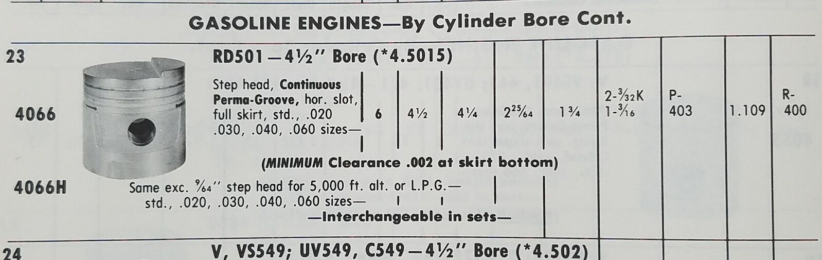

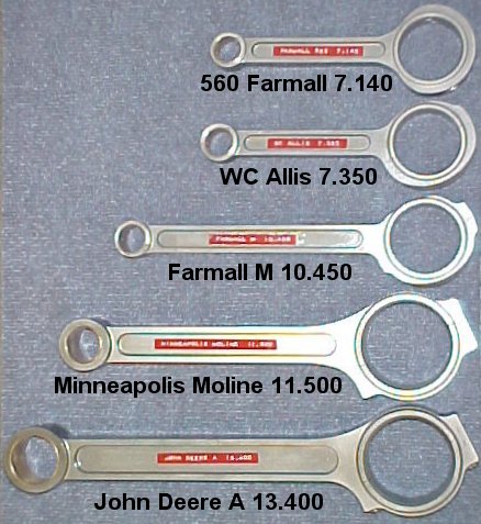

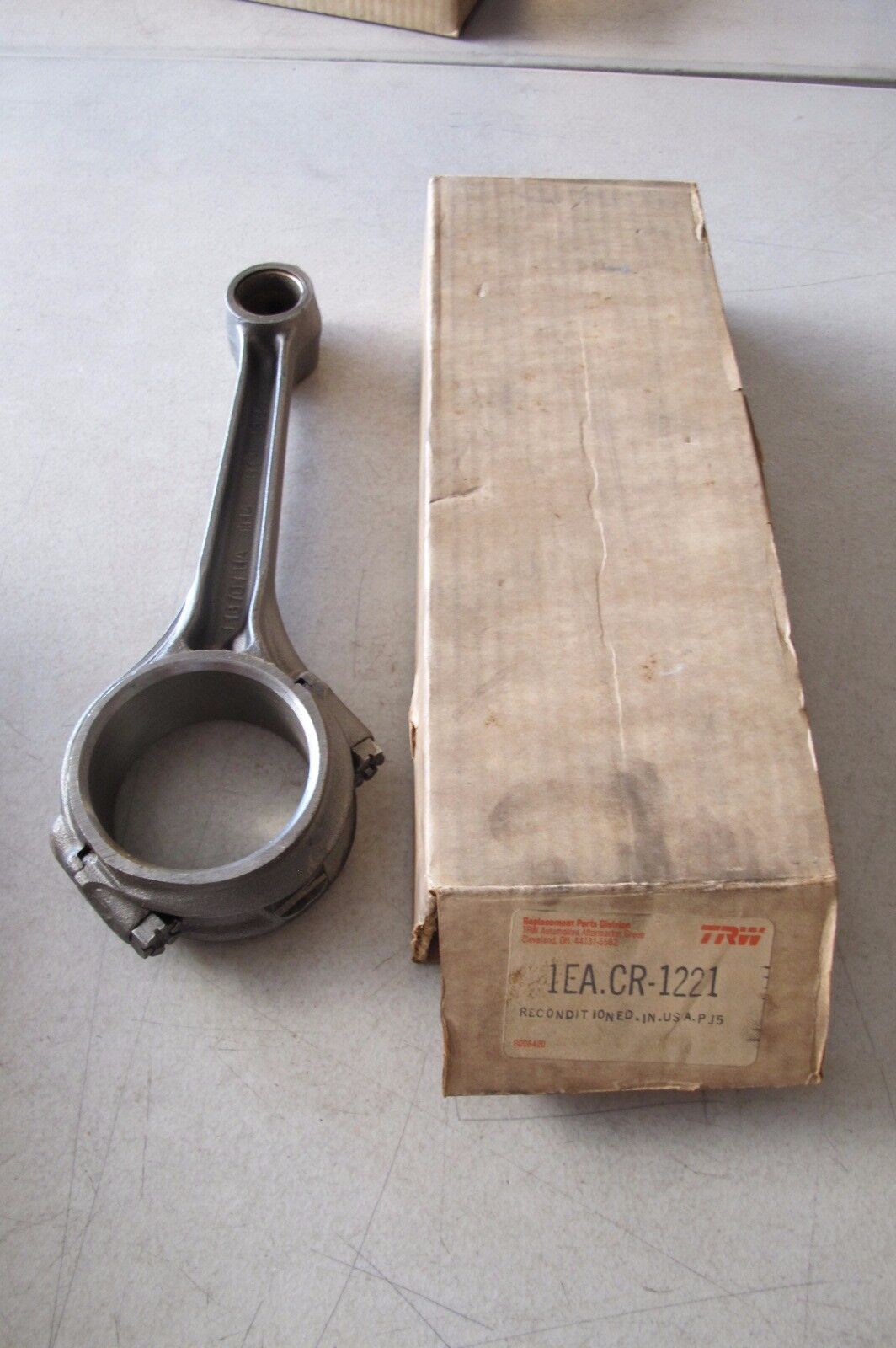

Post #11 by Firepower354 » Wed Feb 06, 2019 1:18 pm
Dave,
I got your email, but it's easier to keep my place here. Ha
No, I didn't get all that far on mine before my move, so it's in real-cold storage ATM.
I had my RD450 block sonic checked, and it should go 4.600 safely, from the 4.503 it is once the sleeves are dropped out.
I bought a set of used BBC 4.530 flat tops that will work fine for me.
An offset stroker grind to use 2.200 BBC rod bearings makes the rods the only custom bits.
I can't recall, but think the Farmall M billet rods will work.
The 501 has greater crank to cam distance, so I'm not sure how much more stroke that 660 incher has, or how much bore the 501 block takes compared to the 450. But 531ci at 4.540 x 5.500 should be enough, with a little boost?
eBay listings for valves all seem to show a lot smaller than the 2.25 or so intake valves mine has. I need to re-research.
Stock split exhaust manifold isn't all that heavy, and a U-bend connecting the outlets, turbo adapter on top at the heat riser flange, would make a beefy setup, and a wastegate can go in the loop below.
2.899 rod bore x 9.00" long 1.110 pin FFR

Post #19 by Firepower354 » Tue Feb 12, 2019 12:30 am
There are always pistons going the opposite way, so not really much of an issue. Crankcase vacuum is more for ring stability in higher revving engines. Red Diamonds ain't. It may add a couple horses at the 4000 rpm or so point.
A 6.7L Cummins isn't a bad comparison. A lot will depend on camshaft and turbo selection. It could cover a vast range of character.
A DT466 may be more in line with the sheer mass. I plan to measure the next one I run across, but think they are not far removed from the Red gasser. Up side of that would be the availability of a billet aluminum head... Gas/E85 converted Cummins pickup engines are popping up more often. CNG/spark ignition models have been in commercial use for a while.
RD450 is 4-3/8 x 5
RD501 is 4-1/2 x 5-1/4 and has the crank lower in the block, farther from the cam, uses a unique set of timing gears from the 318-361-372-401-406-450
Stock rod journals are 2.750 Lots of weight and bearing drag.
BBC rod journal is 2.200
Offset grinding a 450 crank will allow the extra 1/2 inch, but require custom rods. It will take several pounds off the crank, and allow several more to be removed from counterweights. I'd bet 20 could come off, maybe more, after cutting a couple pounds per piston as well.
RD pistons are massively tall so even leaving the crank alone, the RD rods are too short and not very strong anyway.
Rods are 9.00 long, stock with 2.4 or so pin height.
Pin height is an inch closer to deck in a BBC piston, 1.27-1.65 or so commonly
Custom pistons could be made tall enough, but the rods are weak and big ends huge.
My combo, with roughly 1.270 CH pistons, and .250 more crank throw, calls for 9.875 or so connecting rods. YMMV
