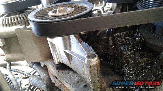

Mine is a '94 that came without AC. I've since added an AC compressor and removed the AIR pump. The old belt was too long for this arrangement. I cut it and used vice grips (first photo) to clamp the overlapped belt and mark it to get the correct length.
The result is a 6K942 (94.2") belt works.
There is an issue though. the bottom alternator bolt head interferes with the belt path. So I countersunk the bracket and used a flat socket head bolt to mount the alternator. All this is with a small frame 2G alternator.
I've since replaced the 2G with a large frame 3G alternator, which the bracket also accommodates, however a 95" belt is recommended. I was able to get the 942 belt on, but it is very tight and I had to swing the top of the alternator in to get it on.
OOPS, the lengths quoted above will be too short for your truck as I had modified my PS/AC bracket to tuck it in about 1" closer to the block. So belt length with the small alternator should be 96 to 96.5" and for the large 3G 97 to 97.5". The large alternator does not have the bolt head interference problem.
2G showing bolt interference proximity.
3G installed.
