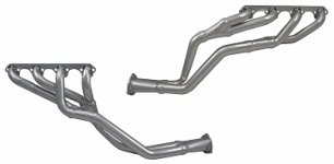

Hi Eddie, I can give you some info on the old tried and true Tri Y headers which really work great on street cars up into the 4000 to 4500 RPM ranges. That would be about right for your 1937 Plymouth 201 Flathead six since they made their Max Factory Horse Power at 3600 RPM and Max Torque at 1200 RPM. The Tri Y's have been in use for over 60 years. These specs would probably would also work for the 6-2-1 design you want to do. On these type headers the the primaries should be just long enough to not get reversion, at about 12 to 18 inch length range. The secondary Pipe lengths would then end up as the remainder so that the Total Header length to the end of the collectors is in the 34 to 36 inch range but you can also go more if you have the room to fit them like maybe up around 40 inches. On the Tri Y's the Cylinders get paired together by the Firing Order so for your six that's 153624, so you would pair 1 & 5, 3 & 6, 2 & 4 these type headers are not a tuned length type. I had my first set of these Tri Y's on my 27 T build in 1966 and they work great. Best of luck on your Header build.
Below are some pictured examples of these Tri Y type Headers
