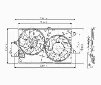

Jackfish, on another post mentioned a dual fan for a ford contour or a mercury mystic.
I found a Dorman part #620-104.
I will check the dimensions to see if will fit my 67 Mustang.
Since i work at Advance Auto Parts this will be an easy task. This is a puller.

On my 67 Mustang, since i have a Scott Drake 3 core radiator the dorman fan is too thick. If i had the stock 2 core radiator it might work since the stock radiator is thinner.
The best deal is install an aluminum radiator with this fan.
I just visited a guy who was building a fox-body with a 351, totally whacked out.
I noticed he too had a contour/mytique fan, and said he swears by them.
Great performance and really thin.
