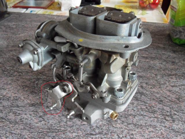

How is the linkage on the carb going to work, I have been trying to search other threads but no luck ( I may just being using the search function wrong) am I going to need to upgrade a to cable linkage instead?
I got my Webers from webercarbsdirect and had good experiences with them. Actually I have a 32/36 and a 38/38 that I hardly put any miles on, a 2 to 1 carb adapter for the small log, and a jet kit that I'm not using anymore since I switched to a large log with a direct mount Autolite. If you're interested I could check out their condition when I get home on Thursday.
Thanks for the picture that helped!
