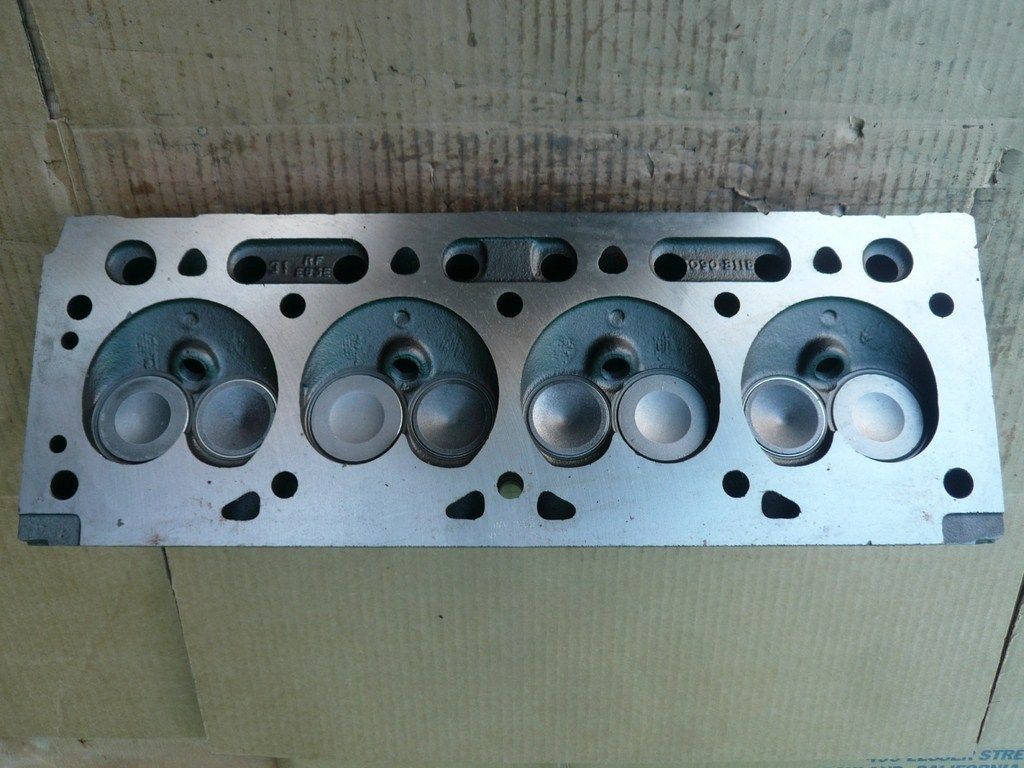

In order to get the 12.7:1 compression I am looking for to improve the fuel economy of my Mustang, I have no choice but to duplicate one side of the HSC Tempo/Topaz combustion chamber of the 1983 to 1994 4-cylinder 2.3/2.5 head on to my E0 head.

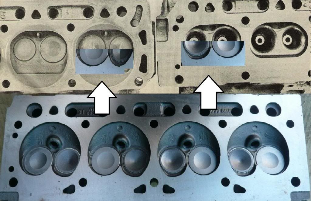

Picture renderings of the open and closed chamber I6 heads in 60 cc on top left, and 52 cc on top right have the 37.5 cc swirl ramp tongue superimposed on them. This is what I'm having my machinist put on my EO head.
What I've done is copied at 60 thou version of the stock head gasket in steel, and added it to the large 60 cc stock 1981 head
Then added six swirl ramp wall tongues set screwed in each cylinder, and welded it into the chamber so it won't fall out. I loose 10.45 cc adding the plate, taking the chamber to 70.45 cc, but then by adding a weld of HSC style swirl ramp wall, about 37.5 cc's is removed to get a 33 cc chamber. I haven't been able to rework the spark plug side like the HSC head above, but the swirl ramp wall does the job on getting the compression ratio right up, as well as improving the paddle wheel rpm of intake flow into the cylinder.

i like the idea you are proposing, with one change. you need to open up the area around the spark plug to properly unshroud the valves for good flow. remember that is where your flow curtain is on these heads.
That was Question one in my mind, and you answered it. I'd been thinking of that, as its what the Aussies and Argentinians did with the 188/221, and the Aussies with the tall deck log 200,250, and 2V 250 heads.
I dIdn't really want to go back on compression, as the relief of the spark plug pocket is a 3 cc loss.

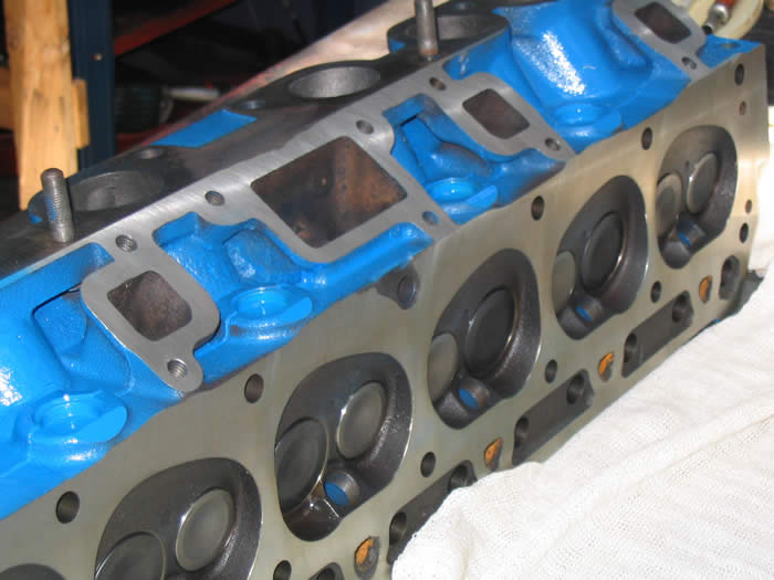

Here is the Aussie 250 2v head's relief on the area about the spark plug.
Of course, the Classic Inlines head does it all with much more class and smoothness, which I can't duplicate in cast iron

actually i think you can duplicate the CI aluminum head, if you are willing to do a ton of grinding in the combustion chamber, after having the heads welded to fill in the areas you want to eliminate.
regarding the plugs, if you are going to a smaller plug, then yes relocate the plug as much as you can. 2mm is plenty of movement if you can do it.
one of the issues with high swirl technology was the actual execution of the technology. ford was trying to do too much with it, and it hurt airflow through the valves. the idea though is grand imo. make the chamber as small as possible initially, and then open it up as needed to get the best airflow through the valves, and recognize where your flow curtain is at its peak.
i think if you get the combustion chambers down to the early 170 size, and then bevel the edges out as if you were doing a 5 angle valve job, i think you will get the compression ratio you want, and the efficiency you are looking for, and you can do it with a flat top piston.
if you can duplicate the combustion chamber in jackfishs picture, i think you are there.
