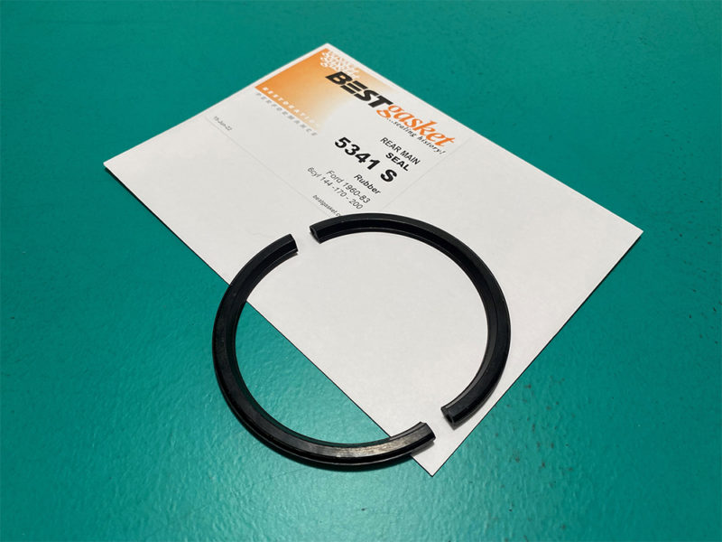

"For anyone looking for a RUBBER rear main seal for a 144, 170, 200 or 250, and can't find the Fel-Pro BS30135, Best Gasket makes 5341S. Just installed one and it is a great fit."
I found a link to the Best Gasket 5341S rear main seal.
I ordered 2 of these. Supposed to be arriving tomorrow. A little on the pricey side at 55.00, but since the Felpro is likely discontinued, I thought having a spare would be good.
Is that $55.00 for 2?
