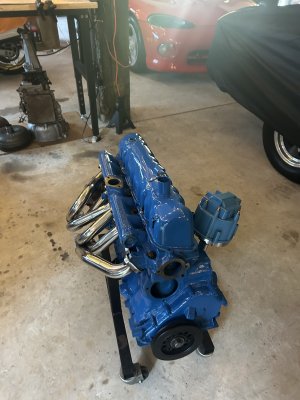

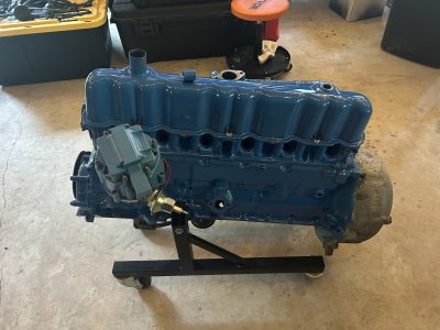

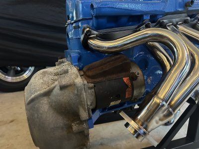

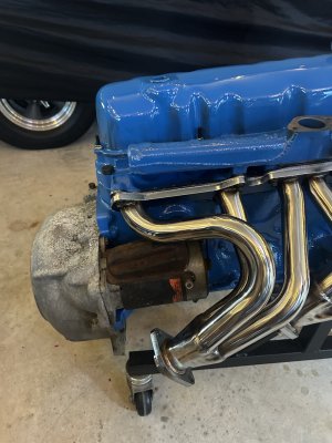

Okay, it’s been a minute since I’ve posted. Too many other projects! My original starter will fit just fine with my headers.
I’m installing a rebuilt 200 while my 170 is being rebuilt.
