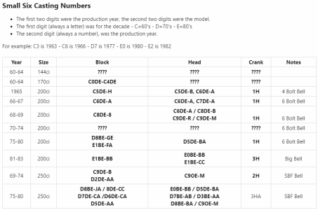

Well some bad luck that is for sure. Check your block and head casting numbers to find out what you have. You can still find a good used 200, it can take a bit of searching but can be a fast way to get back on the road. If your block is not rebuildable you would be looking anyway. I have a spare 250 in my garage just for that reason.
This is like the secret decoder ring to find out what you have:
