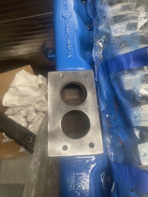

I concur with the above: verify engine condition, add t5, carb and distributor. If you want another level, find a big log head and have it machined/ brazed for a true 2 barrel intake
